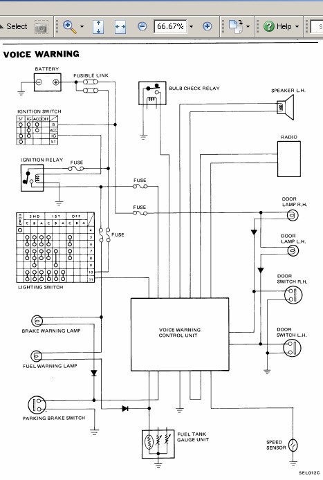

August 13, 200618 yr comment_178361 I don't know if youv'e got your own FSM, but here are some shots from mine. Of course, I've got a 79, therefore no talking lady, but here are the basics of pulling the dash, which is what you will have to do to get to those speakers, I think. Just a thought-perhaps you can splice the lady's wire into the left front speaker wire at the stereo. Do you have factory stereo or aftermarket? As to the second part of your question, I would think that any speaker would do, so long as it fits the port. Link to comment https://www.classiczcars.com/forums/topic/21178-talking-lady/#findComment-178361 Share on other sites More sharing options...

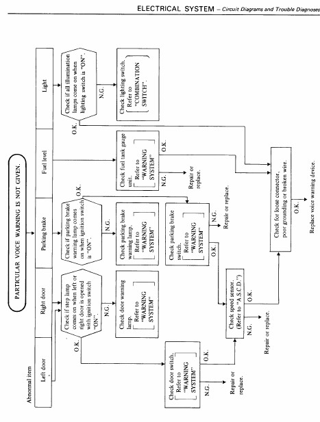

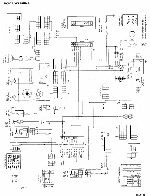

August 14, 200618 yr comment_178455 The speaker are attatched with a pair of phillips headed sheet metal screws, and are removeable from under the dash-be prepared for pretizleitus-or take the dash out and allow WIAAI to take over your day! Here are some more schematics/guides. Will Link to comment https://www.classiczcars.com/forums/topic/21178-talking-lady/#findComment-178455 Share on other sites More sharing options...

April 9, 200717 yr comment_205360 just found my modul at the yard,and looking at the diagrams,the trigger input is ground i assume,I will have to build a subharness in my old accord but it's wired almost the same as the z,don't you just love the Japanese? I assume the ignition relay is not needed,just a switched ignition source. i already have all the diodes installed factory for my warning center in the dash. what is the reason behind the speed sensor anyway? I have a speed sensor since i installed factory cruise in my dx,but i was wondering what it did with the voice. does it maby change the volume or something? I also see the radio has a seperate input, and output. does this module supply it's own amplification? I was thinking of using a voice activated module since i already have a relay setup that changes the front speakers from left and right stereo,to a mono amplified input that goes to both speakers,with only 12 volts in . in other words supply 12 volts and the front speakers disconnect from the stereo and you supply any kind of amplified input into a single input. Link to comment https://www.classiczcars.com/forums/topic/21178-talking-lady/#findComment-205360 Share on other sites More sharing options...
