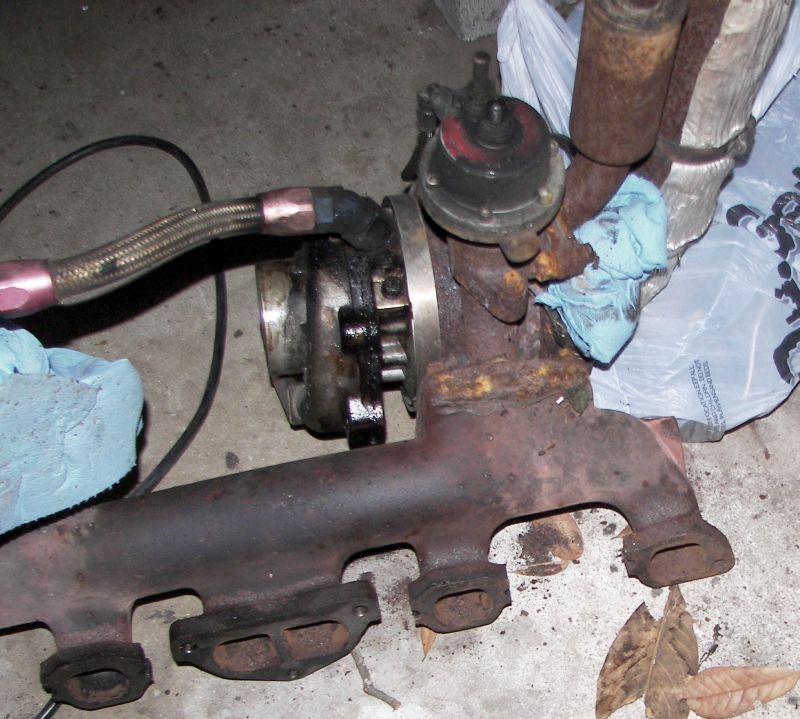

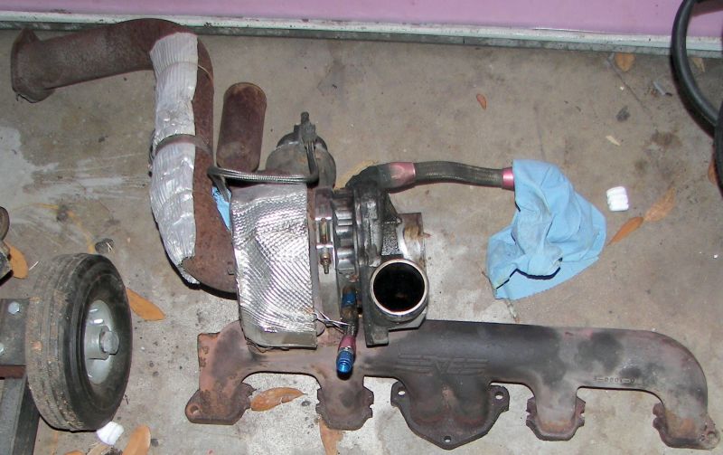

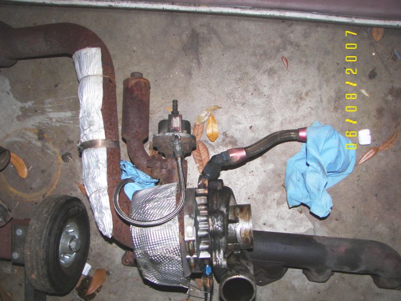

I have a set of installation instructions for the version of the kit you have(exhaust adaptor), but the set I pulled of this car actually has a cast exhaust manifold. Here are a few pics showing the manifold(KDMatt. note the port shape), and the wastegate. I'll clean everything up in the next few days and picture it side by side with the factory(and some upgraded) pieces from and '83.
Will
One further note, this car did have an oil accumulator that drained through the turbo on shut down-but the turbo won't spin...not a good testimonial to this type of oiling system...I have a Oregon Research Technology (not gone) system that interrupts the ignition circuit and pumps oil for ten seconds before allowing the car to start and again for five minutes after shutdown.
