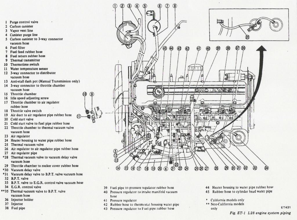

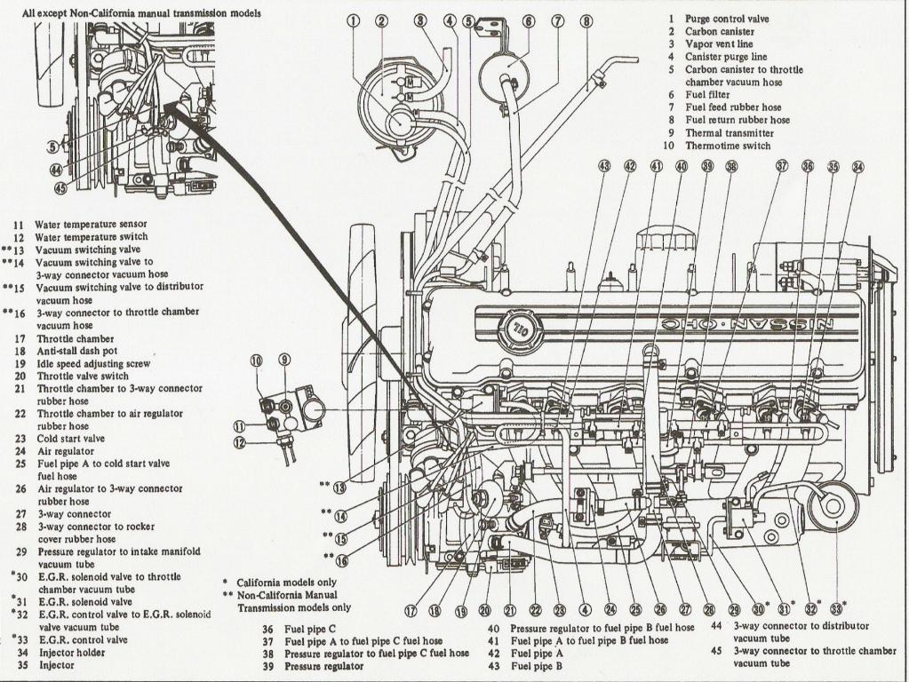

August 16, 200618 yr comment_178719 Still, it's normal. You should also notice vaccum when you remove the oil cap from the valve cover. All ties of the PCV/EGR system. Look at both attachments depending upon which one applies to your car. Link to comment https://www.classiczcars.com/forums/topic/21214-vacuum-from-rocker-cover-vent/#findComment-178719 Share on other sites More sharing options...
August 16, 200618 yr Author comment_178725 Mine is the second one,nd a I already have that diagram someplace. I'm still trying to find out where the P.C.V. thing is, or is that the hose under the intake? No dashpot either.thx Link to comment https://www.classiczcars.com/forums/topic/21214-vacuum-from-rocker-cover-vent/#findComment-178725 Share on other sites More sharing options...
August 16, 200618 yr comment_178727 Should be located on the bottom of the intake and in the center. Should have a fairly good size rubber hose going from the PCV valve over to the pipe sticking out on the left front side of the engine just behind the front timing cover. PCV hoses are still available from the dealer as well. About $16.00 if I remember correctly.webdawg1 Link to comment https://www.classiczcars.com/forums/topic/21214-vacuum-from-rocker-cover-vent/#findComment-178727 Share on other sites More sharing options...
