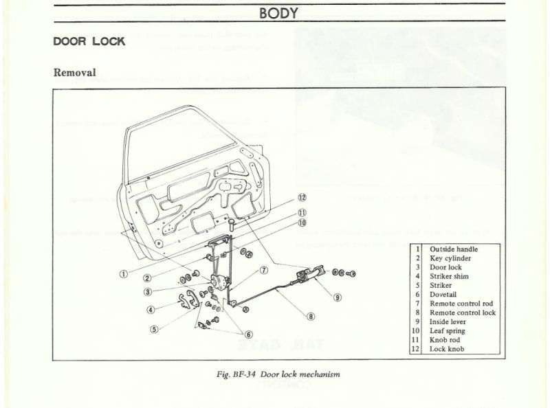

I would start looking for new locks for your car, unless you have tha ability to work on those locks then keep them and fix them. Start with replacing the locks and when you are in the drivers door replace the broken parts you find. You probly have a broken door lock. See item 3 in pic.

I have one key that works for both the ignition and the doors. Thanks for the exploded diagram, I'll take the door skin off again and have a peek inside, I may be able to fix the problem now.

E if the picture of the FSM did not work out or is wrong let me know.
The picture from the FSM, is NOT what was wrong with your post. That was the most constructive part of your "advice". In fact, it's probably the key piece that Prox will use to fix his locks, as I still think he has a misplaced or misaligned rod.
