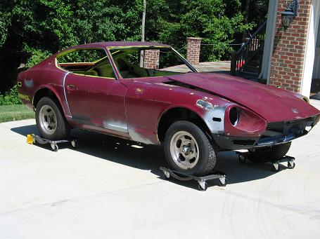

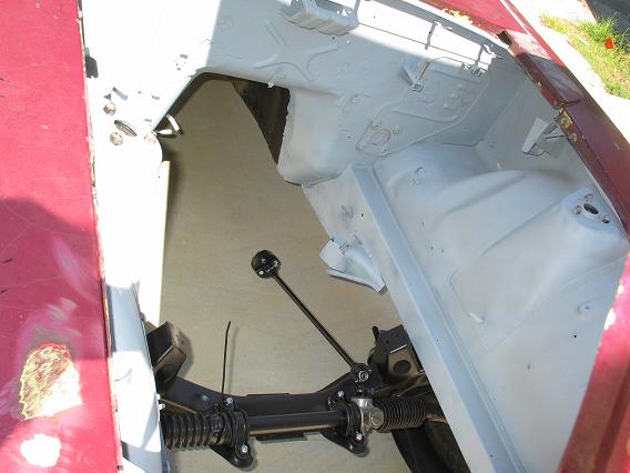

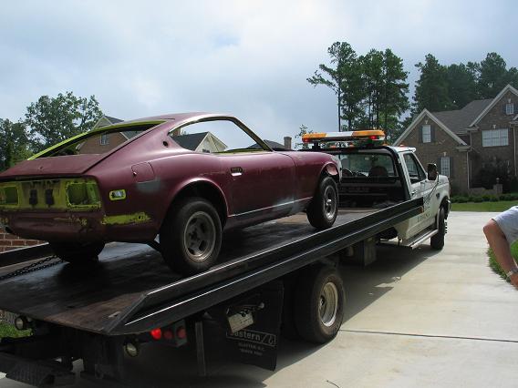

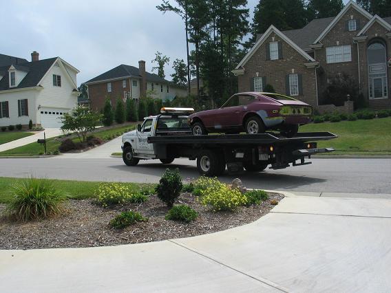

It's been a year since commencing the teardown of my 1972 Z, #81167, and it's finally off to body and paint. Finally found a good shop nearby that didn't flinch at the project and quoted me a reasonable price! Said it would take about 9 weeks to do, so I'm budgeting 12weeks....
Here are some pics as it leaves home for a 3-month spa treatment...Wish me luck and send some good vibes for a smooth unevetful paint job and satisfying result!

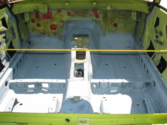

To be nosy, since I can think of no other way to ask, were your floor pans replaced and what is the paint and body going to do...and how much did it cost? I'm planning on painting my car next summer if I get promoted and want some idea of what I can expect to pay for floor pans, frame rails, rocker panels and paint.
Gogriz:
Not a nosy question at all. I had to replace my floorpans after some hard analysis and considering multiple additional expert opinions. Bought them from Charlie Osborne at Zedd Findings, installed by a welder friend who cut me a break on labor, but still ended up being around $900. Did not need the rockers replaced yet, although that might change...Frame rails were fine.
I initially budgeted 10k for body and paint. Estimates are for 6.5-8k, and this guy is a little higher than the average. I'll end up about 15% over budget, which is not too bad when restoring cars. The car is to be stripped, dents/creases fixed, then layer of epoxy primer. Waves/irregualrities are to be filled with standard filler for smaller areas, a fiberglass-based filler (Fiber tech by Evercoat, I think) for larger areas as the regular fillers may crack if applied in too thick a coat. Then (as I'm told) primer, sand, smooth and paint as I mentioned above.
Biggest problem for my vehicle (aside from the understood hidden rust monsters) is the roof. Lots of waves and irregularities. All body shops asked if I could get a new roof--I had no idea it was that bad! After discussion, icluding risks of malalignment of doors, windows etc. it was decided to go with as much metal bumping as possible, then smooth out with filler. I'm OK with that--I've found more problems with poor application of fillers than bad quality product--and I think the end result will be satisfying.
