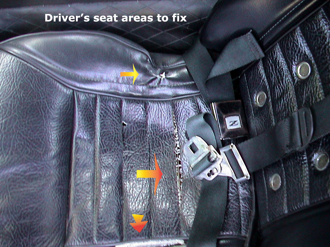

We're in the same boat, the driver's side seat bottom of our 1971 240Z needs new foam, needs the original cover resewn (sun wiped out the stitching), and those little green straps underneath that apppear to hold it all together need be replaced. Does all this stuff come in a kit, or can you do things yourself with alternate things? In our case 3 of 4 seats are great (tops & bottoms).
Also curious what the rings are you mentioned, perhaps that's part of the greet strap array ?? Sorry to sound out of it, but truly a novice. LOL
