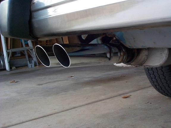

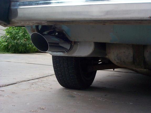

August 23, 200618 yr comment_179620 But as stated, 2 pipes may sound better, in theory. Not too sure about that, though. I'm not an acoustical engineer. 2 pipes on a tip does sound a little different. I went from one large pipe to a dual tip and it made the exhaust sound a little louder and maybe a little higher pitched. I was going for look rather than sound though, and it wasn't enough differnece to make it noticeable. Link to comment https://www.classiczcars.com/forums/topic/21261-dual-smallerexhaust-tips-instead-of-single/?&page=2#findComment-179620 Share on other sites More sharing options...
