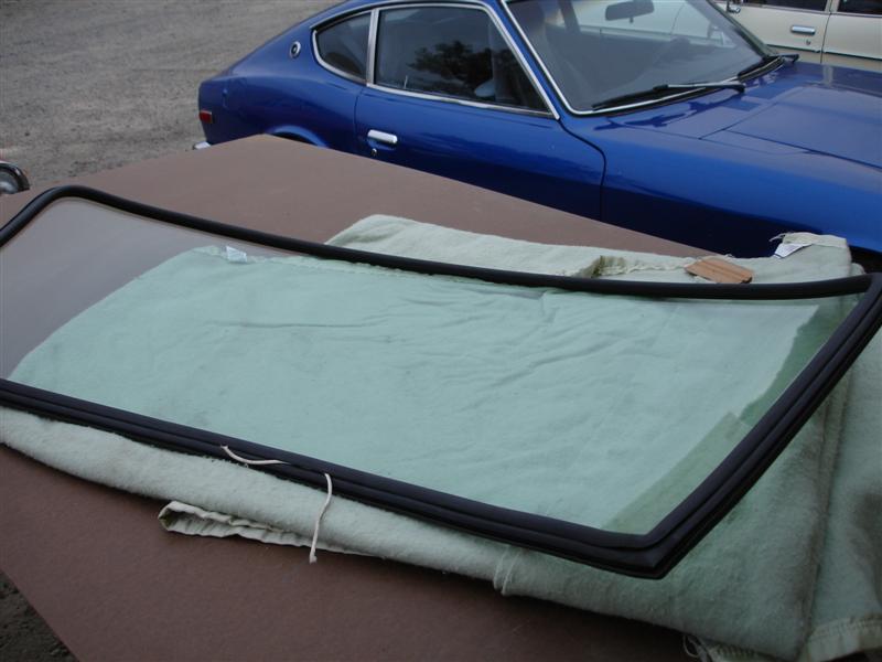

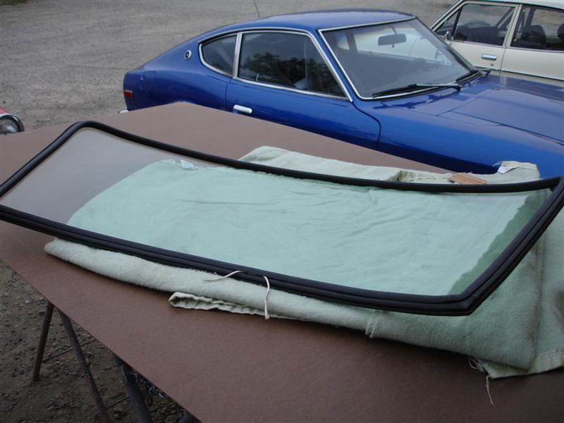

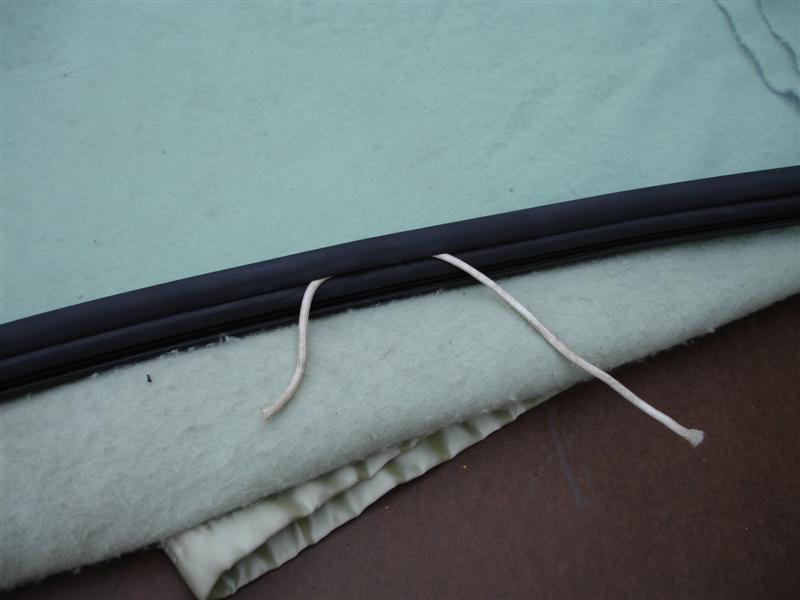

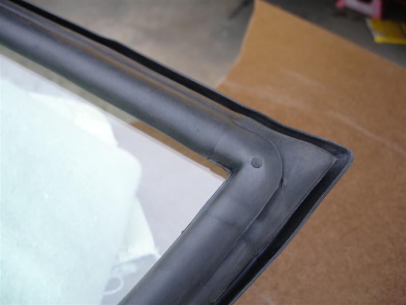

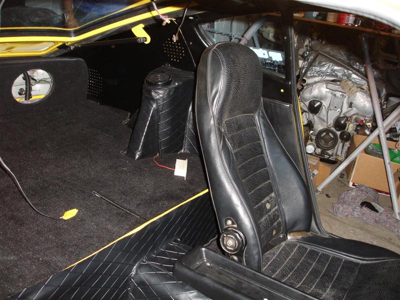

Hi guys, here's an update. Photos attached show us actually installing the front windshield. Bryon and Steve had done this before, but, it was my first time. The trick is to use a small rope and put it between the rubber before the window is put into place. Once the windshield is in place, the rope can be pulled out slowly from the inside and it sucks the window into position.
Put a little windex or soap on the rubber and it will make it a lot easier to work with. :)

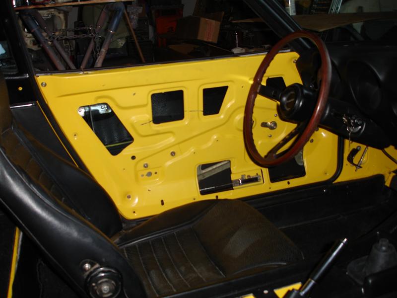

Your right, my Z is at Les's shop at the moment. I wanted to get a few things done prior to taking it up to the JCCS show on the 30th.

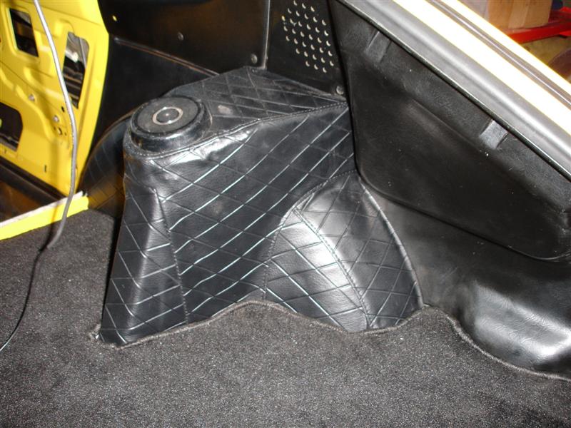

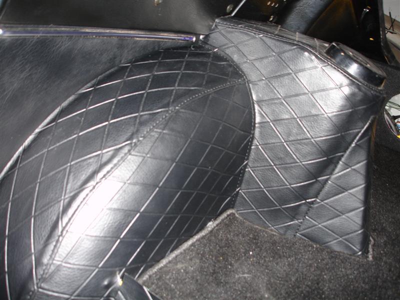

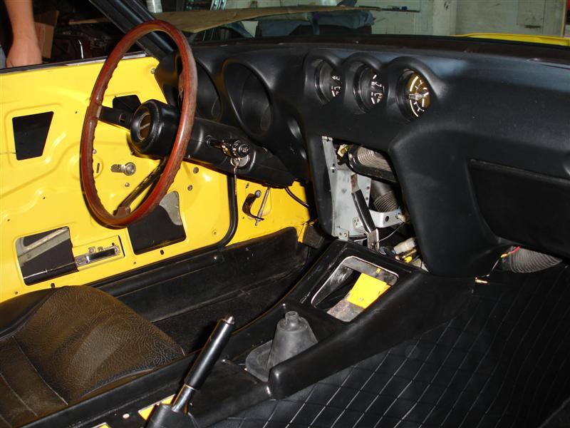

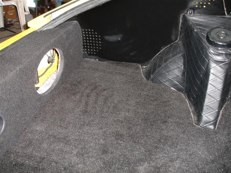

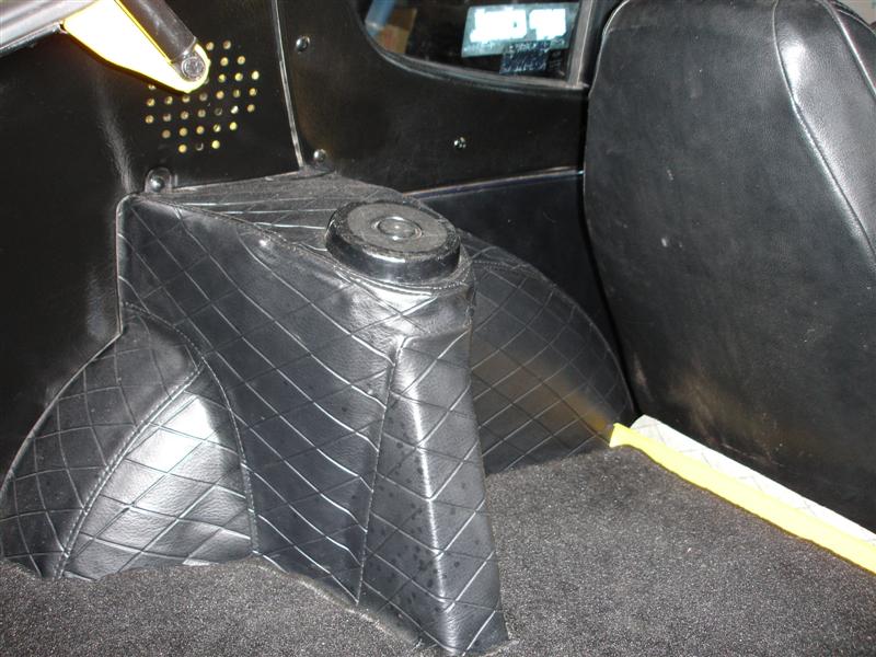

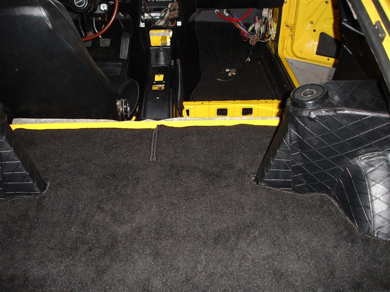

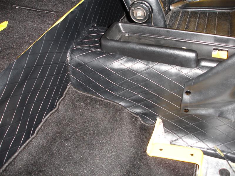

The vinyl is glued down. :) We actually put a layer of jute behind the vinyl to give it some additional insulation properties. It just didn't look right glued directly to the metal.
Carpet and vinyl were purchased from Les Cannaday at Classic Datsun. His stuff took longer to get, but, it was worth it in the end.

The vinyl looks a tad 'cushy' in a few spots is why I asked. It makes sense to pad behind it. I will probably use some noise deadening material.
That carpet looks very good, I'll talk to LES when I make my next purchase and see if he ships to Canada.

Good idea on the extra backing for the vinyl. Whether it's Jute, Tar-Mat, or..., it helps keep heat and noise out.
