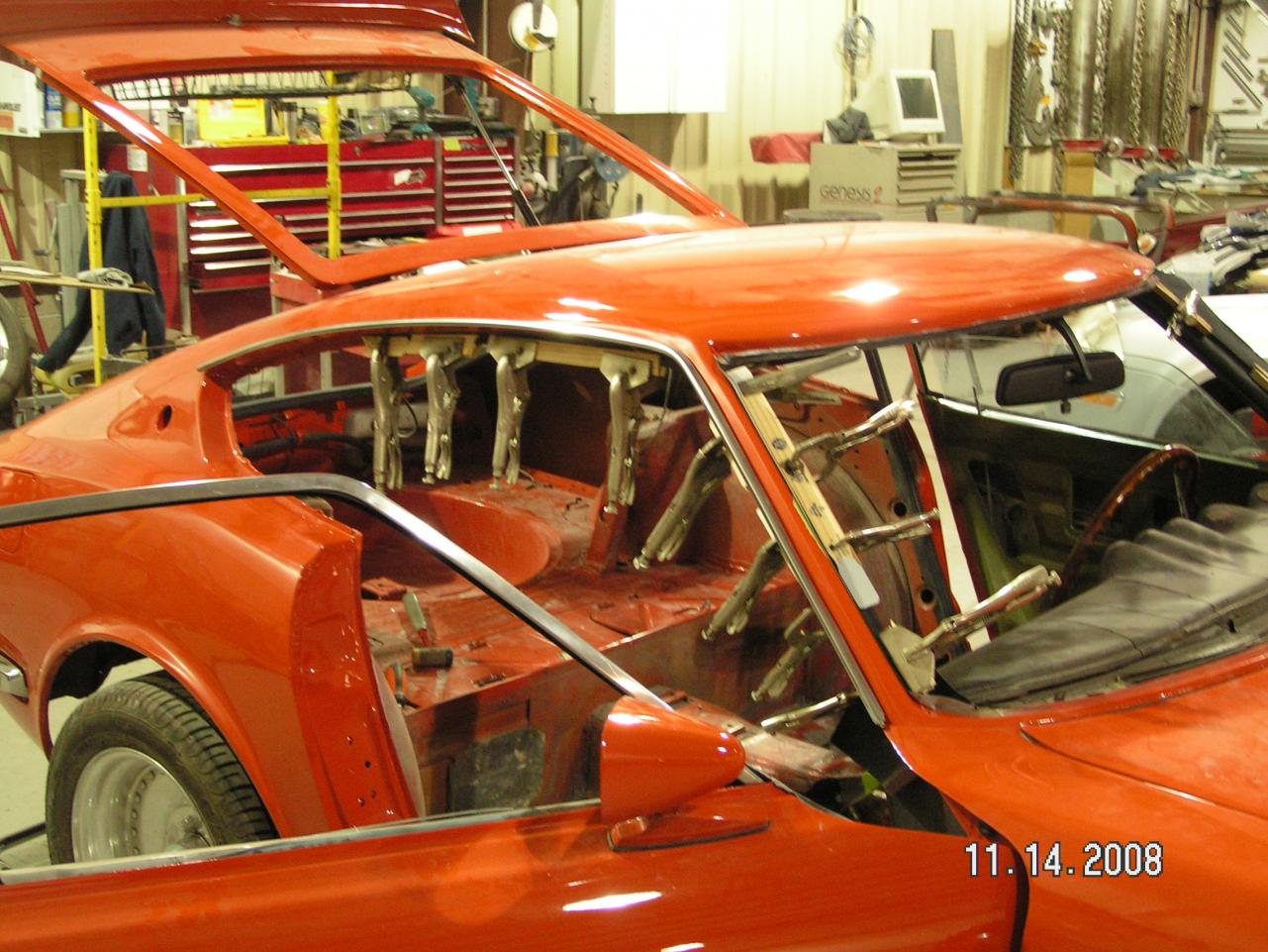

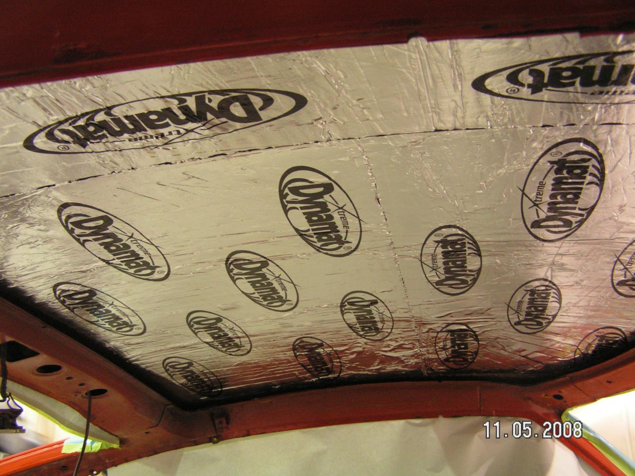

For future reference, when your headliner is out is the perfect time to soundproof. It makes a HUGE difference in the roof sound quality. I am also attaching picures on how I attached the other pieces. It was a complete pain in the azz but it does help if you have a very patient helper to complete the project and don't get in a hurry. Don't buy the ultra fast drying glue.....you will need a little wiggle room
Travel'n Man, did you use adhesive on the dynamat or just apply it to the roof as you would anywhere else? I assume you then applied the headliner to the dynamat with a spray adhesive. Does that make sense?

You are correct........I cleaned the surface of the metal and attached the Dynamat with the roller - after pre-fitting because once it is attached .......well, it's there to stay. I then made sure my headliner was prefit cut and put a piece of tape in the middle where I knew I needed to start once glued. I then sprayed both side and let set up. Then, just lilke the ones before me start in the middle and work out. I tucked the side into the metal frames.......that was the easy part. Do be sure to support your headliner and let the eveything totally set up overnight before you move on the the front and side pieces.
The three other pieces were extremely hard to stretch and fit and keep in place and clamp - you really need 4 hands working at the same time to do a good job. That is why I posted pictures because hopefully it will help somebody working on the headliner and the front and side pieces.
