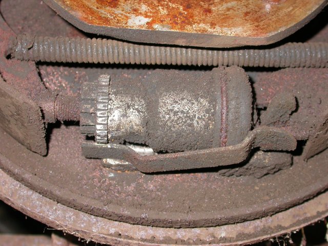

June 7, 200321 yr comment_40146 Originally posted by billcapp 2MANYZs had the best advice. I too had a problem drum. I just cleaned up the studs, applied penetrating oil and rapped it all around from behind and on the sides with a hammer and blocks of wood. Just keep at it; it will eventually come loose. Yup. Just finished removing the drums on my '70 240Z. Cleaned up around the studs and center, soaked with Kroil. Did it again. Did it again. then pounded around on the front outside of the drum with a 2 lb rubber mallet, and then from the back around the fins with a block of wood and a three pound sledge. They came loose within about three revolutions (pounding from the back about every 90 degrees) on both sides.EDIT: Beandip's post (next one) reminded me that I also backed off the adjuster quite a ways before doing any of this. The drums spun freely before I started beating on them. Also, I had to push DOWN on the adjuster arm, not up. One small screwdriver under the cylinder to push down on the arm, and one beside it to turn the knurled wheel. Link to comment https://www.classiczcars.com/forums/topic/2134-rear-brake-drum-stuck/#findComment-40146 Share on other sites More sharing options...
June 8, 200321 yr comment_40191 bingo the last two posts have it in the nose. If you havent turned the adjuster to loosen the linings from contact do so through the hole in the face of the drum . look in the manual and see how the adjuster works and if you lift the adjuster high enough it will catch and then you can turn the star wheel. My adjuster wouldent stay up and I ended up destroying the drum by drilling wholes around the studs unitill I loosened it and broke the cast iron sleve with a sledge . It's not easy to get the drum off but you can save it . and yes striking the drum like scanlon said really will loosen it only I used a rubber mallot under normal conditions , and they come right off. Use anti sieze around the center and a little on the face of the axel when you reassemble it. You can drill out the access hole to 1/2" and not hurt anything and will help . Link to comment https://www.classiczcars.com/forums/topic/2134-rear-brake-drum-stuck/#findComment-40191 Share on other sites More sharing options...

August 19, 200321 yr comment_47329 Mark,Once you push down on the wheel cylinder arm, which way do you turn the knurled wheel? Toward the center of the car or away from the car?TIA,Marty Link to comment https://www.classiczcars.com/forums/topic/2134-rear-brake-drum-stuck/#findComment-47329 Share on other sites More sharing options...
August 19, 200321 yr comment_47333 Originally posted by Marty Rogan Mark, Once you push down on the wheel cylinder arm, which way do you turn the knurled wheel? Toward the center of the car or away from the car? TIA, Marty Toward the center of the car at the bottom of the wheel. Here's a pic of the drivers side on mine. Note how the serrations on the wheel will "catch" on the bar at the bottom if the top of the wheel would turn toward you. Thus, it will "click" over the bar and adjust the brake if the top of the knurled wheel would turn away from you. So, to loosen the brake, use one screwdriver to push the lever arm down, and another to push the BOTTOM of the wheel AWAY from you, toward the center of the car. Hope that makes sense. Note that these are really early wheel cylinders too. There are some changes over the years, but hopefully a '71 will be similar. Good luck. Link to comment https://www.classiczcars.com/forums/topic/2134-rear-brake-drum-stuck/#findComment-47333 Share on other sites More sharing options...
