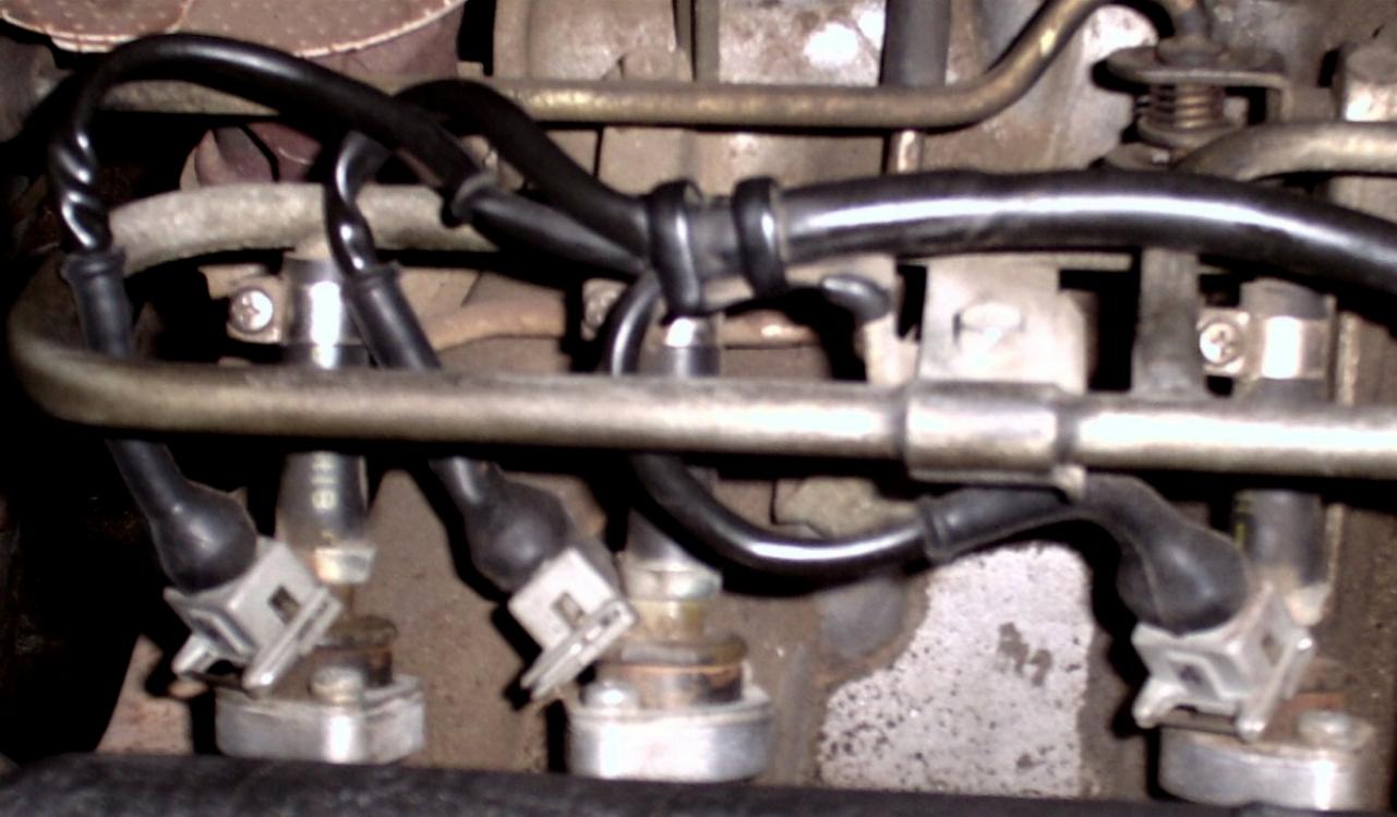

The modern injector clips won't fit our type of injectors. I have taken the entire BMW harness on a couple of occaisions with the idea of using it in its' entirety, but it is much simpler to do the individual connectors than it would be to use the BMW harness. BMW 6 cyl from the early to mid 80s have the connectors as well as Volvos but I don't know which years. Here's the back three on my Z. They look better than OEM IMO.
