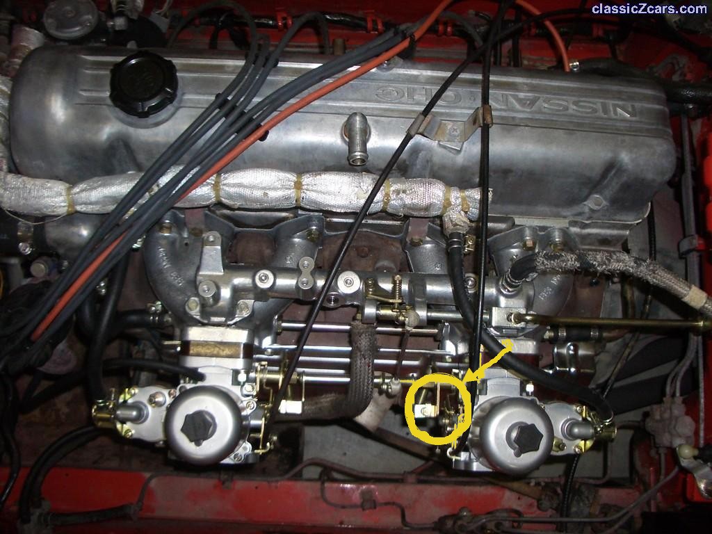

September 5, 200618 yr comment_181206 I would focus my efforts on the throttle and linkage. It's hard to imagine a vacuum link that would provide enough air to cause the car to keep accelerating beyond 80 mph! And to Beandip's point earlier, even if the piston wasn't falling, with the throttle closed your engine would not continue to accelerate at that speed.If you can get your buddy to help, one of you should look at the linkage while the other sits in the car and floors the accelerator. Do this with the engine off:) You're looking for something that could cause the throttles to stick open. Let us know what you find. Link to comment https://www.classiczcars.com/forums/topic/21416-help-su-carbs-suddenly/?&page=2#findComment-181206 Share on other sites More sharing options...
September 5, 200618 yr comment_181207 Hmm, you know, I've seen cases where one of the pair of carbs will have the throttle lever catch on the choke linkage and hang there. This could definitely cause this type of thing. I know Bryan won't mind me messing up a copy of his picture for a good purpose like this. Look closely at yours where I have circled in yellow. Link to comment https://www.classiczcars.com/forums/topic/21416-help-su-carbs-suddenly/?&page=2#findComment-181207 Share on other sites More sharing options...
