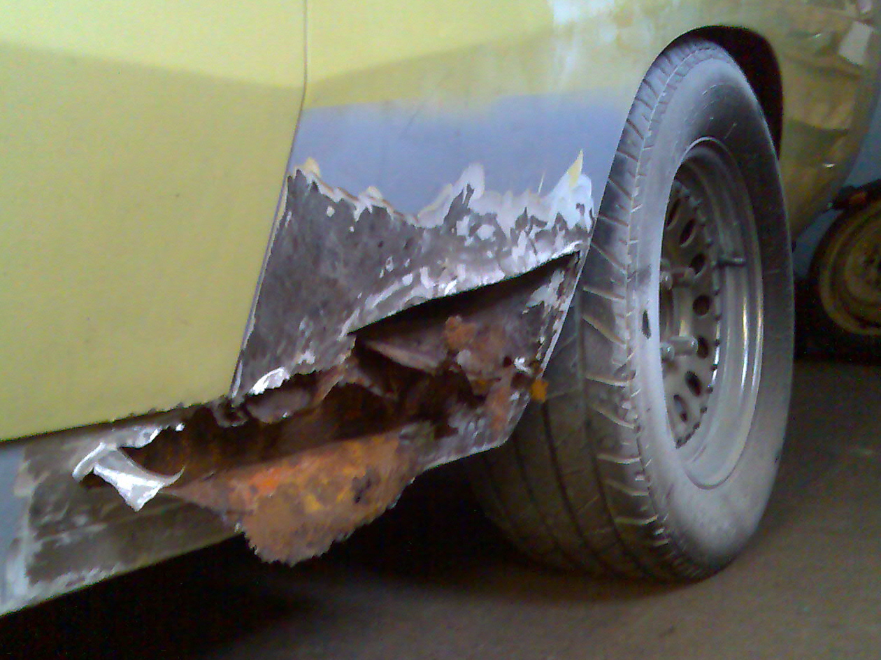

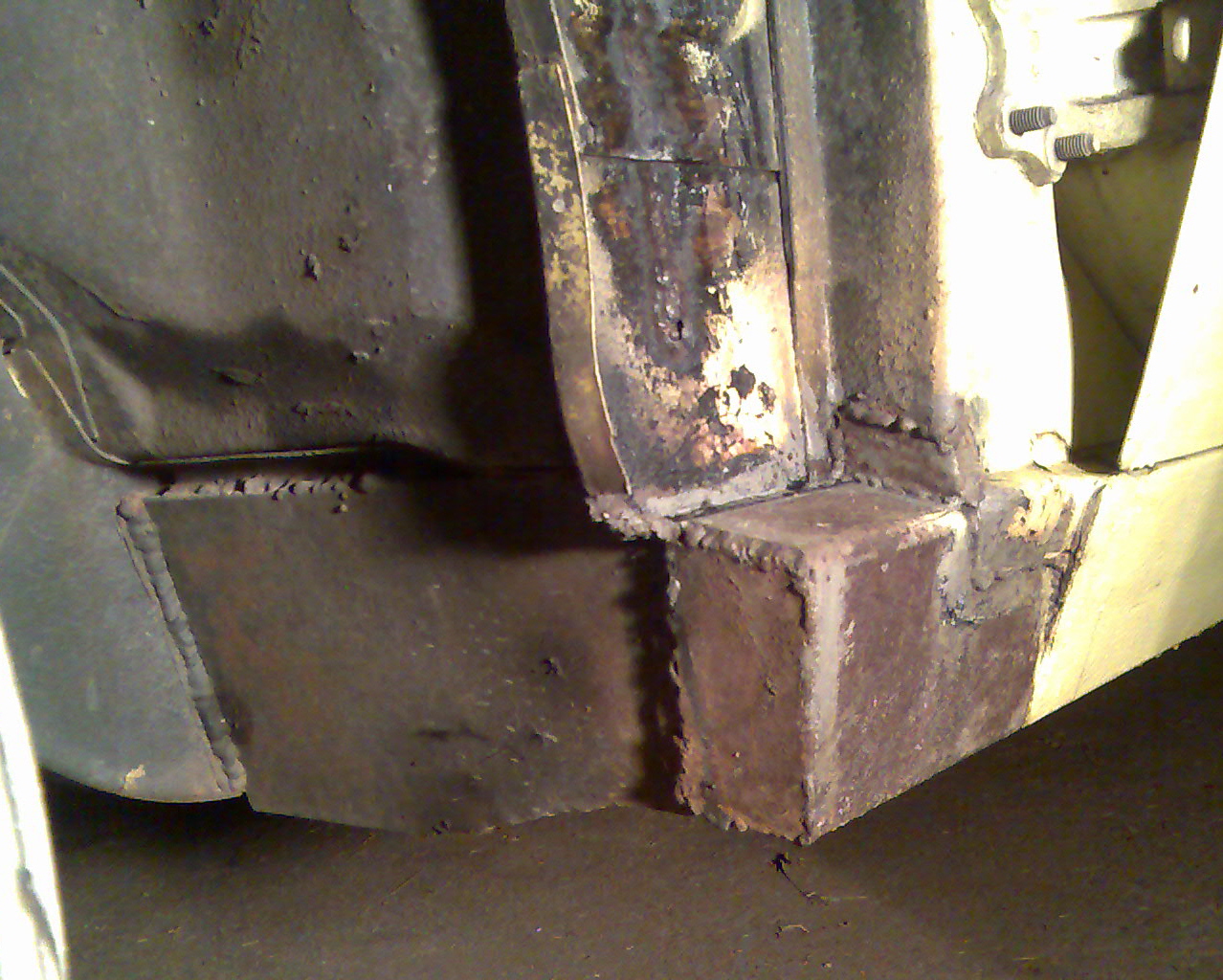

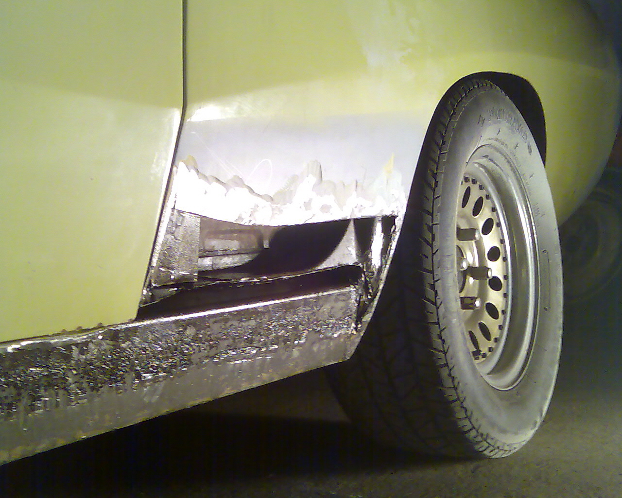

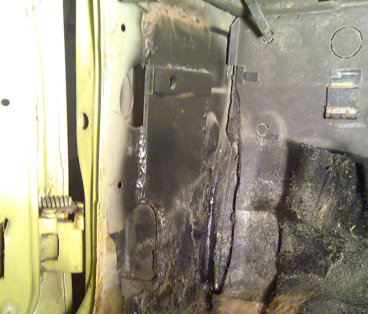

I have just started on the convertible again. I've added a couple of before and after shots of one of the rusty sills you can see some of the box section chassis she's had attached. I'm about to pay $1200 + GST to get all the rust I've cut out welded up, I'll be doing the major sanding work and priming of the car. A friends workshop will do the colour finishing coats for free but he doesn't want to know about the rust work.
Do you think $1200 is reasonable? there is about 3 days of work for a panelbeater to do.

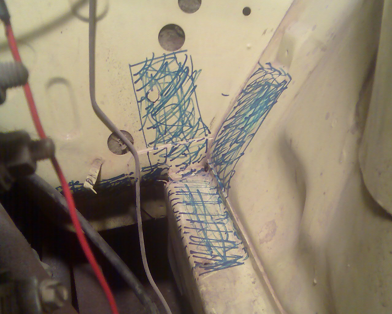

I'd like to strengthen the point where the chassis rails meet the firewall inside the engine bay. All the strengthening so far has been from the firewall back (see pics).
When all the engineering work has been finished I'll post photos of the diff, etc.
Not sure about your specifics, but is you are talking about three eight hour days, your time estimate is accurate, he is not using premade parts, and does excellent work, that comes out to $1200/24 hours.
or $50 and hour-I reckon that sounds pretty good-for this side of the pond!
Will
Thanks Will, I was pretty happy with both prices as there's 10 places in total to be welded up and as you mentioned, the making up of all the parts.
Let's face it if I tried to get the rust done any cheaper it would probably be a shithouse job and rust again in 2 years.

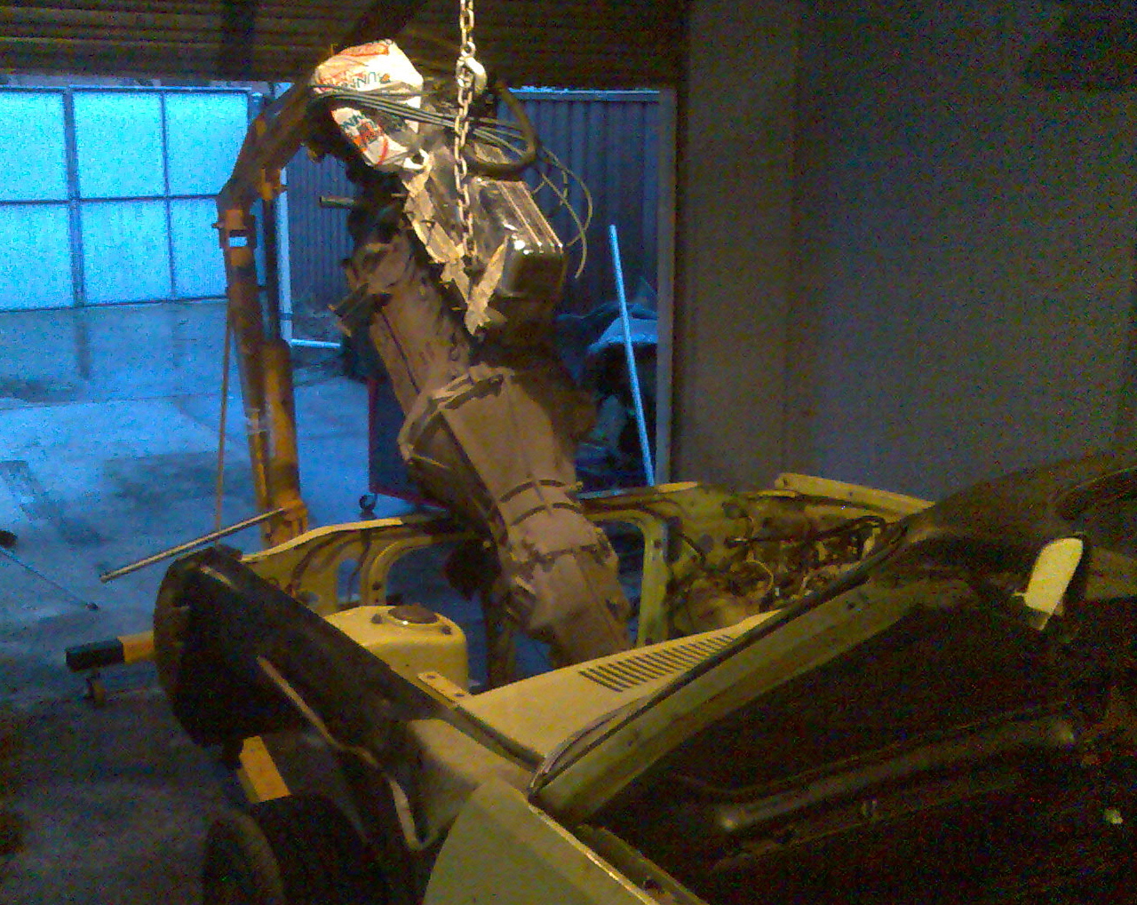

I pulled the engine out on the weekend, its up for sale if anyone is interested. I will put it on ebay soonish if no one wants it.
Specs are
L24 5 speed electronic ignition extractors all other accesories
was running webber two barrel car but has twin su manifold as well.
Head gasket was replaced 8000kms ago
pulled 195kmh but ran out of road had 200 in it,
clutch is on the way out but still drives with out slipping.

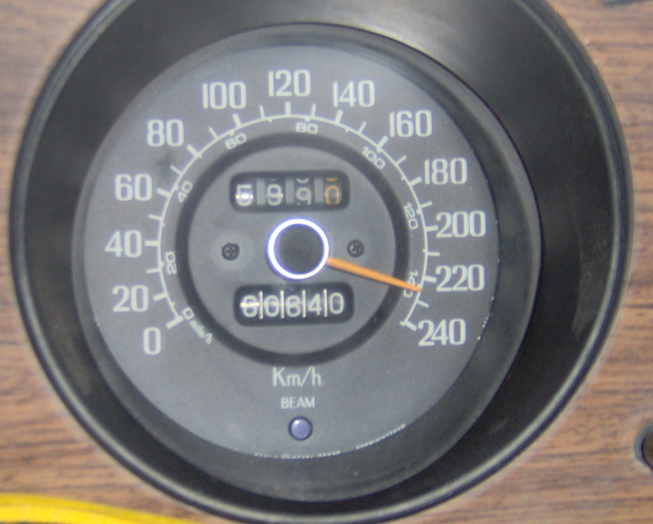

I put up a picture of the speedo while I had both back wheels in the air and floored it, it wound off the clock but I missed the shot. I guess it was doing somewhere near 270km. I couldn't do it again as a retread had started to delaminate. LOL.

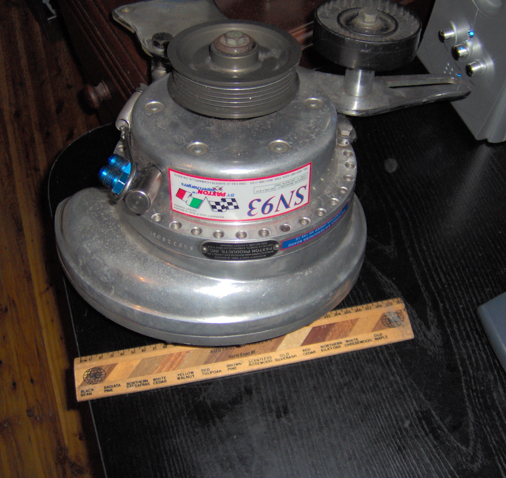

The other is a centrifugal blower I have sitting around, it will get put on after I stroke the v8 to a 390cu in. I'm hoping someone in Australia starts selling kits to convert you car to run on hydrogen before this happens.
