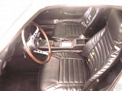

Posted September 7, 200618 yr comment_181392 Saw these with the following EBay auction: http://cgi.ebay.com/ebaymotors/1972-DATSUN-240Z-RESTORATION_W0QQitemZ300024643413QQihZ020QQcategoryZ6187QQssPageNameZWDVWQQrdZ1QQcmdZViewItem Those seat reproductions look real similar to all the ones I've seen floating around on EBay, MSA, CDM etc...Are they supposed to look like that? Looks to me like maybe they didn't replace the foam, or if they did, it's a bad home-done job... Recovered seats should look a little---tidier--shouldn't they? Not at all trying to be overly critical, just want to know what I'm getting into as I eye my own set in my garage.... Any advice for those who've redone seats to avoid the wrinkly-look? Thanks, Steve Link to comment https://www.classiczcars.com/forums/topic/21464-seat-recovering/ Share on other sites More sharing options...
September 7, 200618 yr comment_181395 Adding a 1/4" of padding, and some careful use of a heat gun/hair dryer will go a long way to get rid of the waves. Perhapse a little more care in installation would have helped too, proper placement of hog rings should have held the material tight over the seat bottom foam, the back just needs more padding or to be pulled down more.WIll Link to comment https://www.classiczcars.com/forums/topic/21464-seat-recovering/#findComment-181395 Share on other sites More sharing options...
September 7, 200618 yr Author comment_181397 Will,I thought the heat gun was used to help stretch the material for better/easier installation, then when cooling it would contract and be tighter. How would heat help the "sagging" effect?"Thanks,Steve Link to comment https://www.classiczcars.com/forums/topic/21464-seat-recovering/#findComment-181397 Share on other sites More sharing options...
September 7, 200618 yr comment_181401 Steve,The sagging is due to variations in the tension of the material, equalize the tension, the sags dissipate. Heat alleviates the stresses that cause the variation in tension, and thereby the sags...Will Link to comment https://www.classiczcars.com/forums/topic/21464-seat-recovering/#findComment-181401 Share on other sites More sharing options...

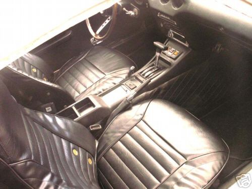

September 7, 200618 yr comment_181579 I bought the foam and upholstery kit from MSA and am very happy with how they turned out. I left the upholstery out in the sun for about an hour which made it easier to install. I also used a spray adhesive on the foam as I installed the covers. As you can see from the pictures, there are still a few wrinkles. Keep in mind that the foam made the seat bottoms much higher than the originals. They are also virtually flat so the lateral support isn't as good at the orignal flatter seat cushion. Andre Link to comment https://www.classiczcars.com/forums/topic/21464-seat-recovering/#findComment-181579 Share on other sites More sharing options...
September 7, 200618 yr comment_181582 Looks very good!Will Link to comment https://www.classiczcars.com/forums/topic/21464-seat-recovering/#findComment-181582 Share on other sites More sharing options...
September 8, 200618 yr comment_181599 z scout- i see there are no vent buttons on these covers. are they not on the 280 seats? Link to comment https://www.classiczcars.com/forums/topic/21464-seat-recovering/#findComment-181599 Share on other sites More sharing options...
September 8, 200618 yr comment_181615 I think the '77 and the '78 don't have vent buttons on the seat backs. This is on a '78 280z.Andre Link to comment https://www.classiczcars.com/forums/topic/21464-seat-recovering/#findComment-181615 Share on other sites More sharing options...
