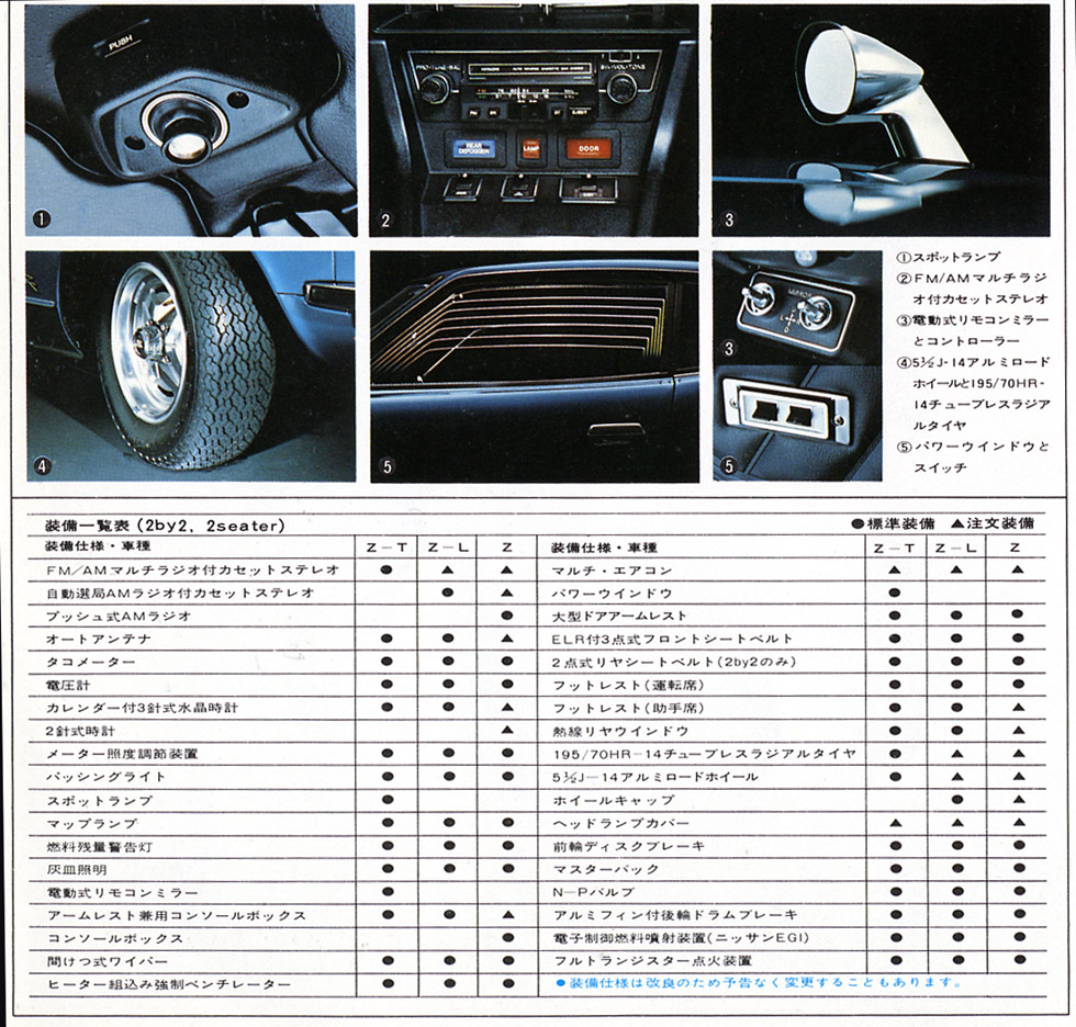

I know that the Fairlady Z got power windows before they were offered here in the USA. Does anybody know when and what the switches looked like? Part numbers would just be too much...

They were first seen on the C-S31 group range, released in July 1976.
Here's a scan from the relevant model range catalogue, showing some of the options available. Power window option is second item down on the right hand options column.

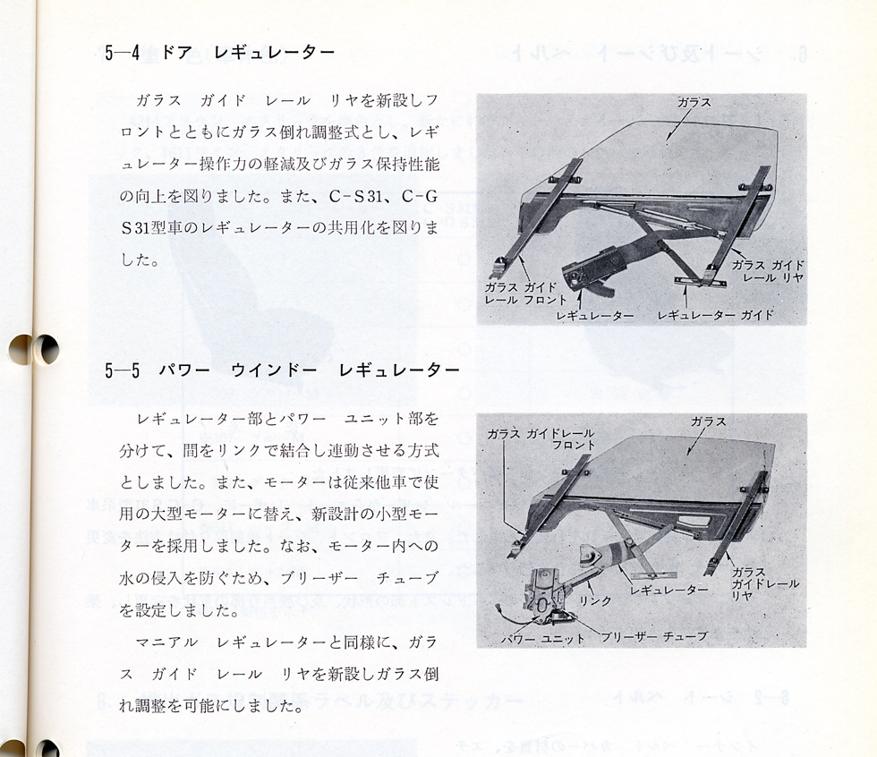

As for PW , it is not just switch & motor added to non-PW door. PW is a completely different setup and that the regulator is different, motor (of course), and the reinforcement panel. To be picky, door panels are different too, (minor details). Without the reinforcement metal panel, the power of PW will twist and bend the door metal. As for PW switch chrome covers, they were not assigned with parts #s from the begining.

Nissan's Z-10 'Service Shuho' book for the C-S31 and C-GS31 model range carries an interesting illustration on the differences between the manual and power window mechanisms. Looks like the metal plate 'Bottom arse'y' ( which holds the door glass ) is different too?
Here's a scan:
