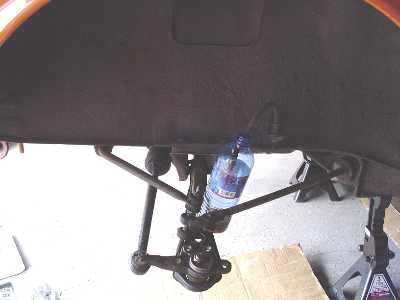

September 9, 200618 yr comment_181799 Hey Bill. The springs can wear without the struts being bad. And this can cause undo wear on the struts. Quite frankly if you replace them both the benefits will payoff. Remember, the new products have had 30+ years of technological improvements. Obviously if you shop around you will find the best deal. I believe a lot of guys have used www.shox.com. The MSA springs are ~ $185 I got the Eibachs for $217 last christmas from MSA. Tokico HP's (a quality daily driver mild performance strut) ~ $340 from MSA but I got mine from www.sportcompactonly.com for $289 including shipping. The complete urethane master bushing kit (MSA) was like $170 plus $32 for the Bump Stops. My Total Was ~ $710 It is like driving a completely different car. If I had to do another one I would go the same route for sure. Also don't forget to check your tie rods and ball joints... my tie rods were fine and I replaced the ball joints about 6 months earlier. Nate I attached some photos... -The disentegrated bump stop! -The wheel well with something missing -The old struts that refuse to come out and play... yeah they were a little worn out. Link to comment https://www.classiczcars.com/forums/topic/21502-need-help-with-springs/#findComment-181799 Share on other sites More sharing options...
