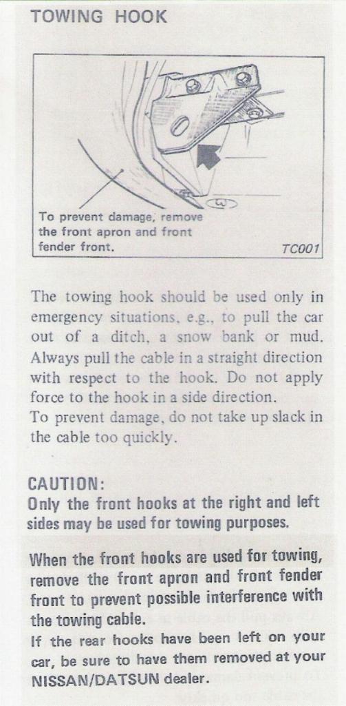

I subsequently went to my own Datsun 260Z Owners Manual Issued December 1976(050070) and found on page 43 under Towing this :
Warning:
a) Only the front hooks at the right and left sides may be used for towing purposes. Do not use the rear hooks for towing as these have been designed as tie down hooks and are not strong enough to stand up to towing.
Be sure to have the rear hooks removed at your NISSAN/DATSUN dealer if they have been left on the car.
B) The towing hooks should be used only in an emergency situation eg to pull the car out of a ditch, a snow bank or mud.
When towing do not take up the slack too quickly.
Always pull the rope in a straight direction with respect to the hook. Do not apply force to the hook in side direction.
c) It may be illegal to tow a car on the highway with a rope.

I do not pretend to have uncovered all of the relevant information in this matter and am sure that others will be able to chime in. But it would seem that at one point in production there was a change in the quality and placement of the tie down hook that accompanied a change in statements from the manufacturer with regard to the suitability of the feature for use as a tow hook (the picture in Bulletin 215 actually shows a ring).
If members are thinking of using the tie down hook/ring for towing then they may be well advised to check the year of manufacture and their owner’s manual before doing so.
