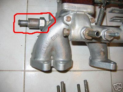

September 23, 200618 yr Author comment_183476 do i need this part,. mine broke off, and i cant seem to find a replacement. I have temporarily bypassed this piece with a tube of clloant heater hose. thanks:classic: Link to comment https://www.classiczcars.com/forums/topic/21654-anyone-else-got-gas-in-the-oil/#findComment-183476 Share on other sites More sharing options...
September 23, 200618 yr comment_183479 do i need this part,. mine broke off, and i cant seem to find a replacement.I have temporarily bypassed this piece with a tube of coolant heater hose. thanks:classic:this is a thermostat controlling the temp in the intake . I never had one of these on my engine since I have owned my Z , and no problem so far after this long. As to the fuel pump bolt holes with stripped threads . I recommend taking the car to a mechanic and have a Helicoil installed . I believe this is the best remedy. Shouldn't be vary costly at all . Gary Link to comment https://www.classiczcars.com/forums/topic/21654-anyone-else-got-gas-in-the-oil/#findComment-183479 Share on other sites More sharing options...
