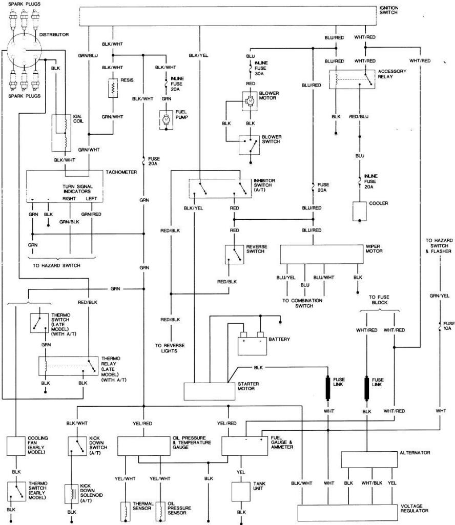

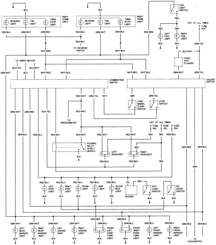

Hello Mrs LR here asking for DH does anyone have a 240Z 1972 wiring guide? I ordered one online moments ago, but was wondering if any one had any ideas why our little one would be showing it as discharging after going through 2 alternators and a new battery???? Any help is gladly appreciated...
