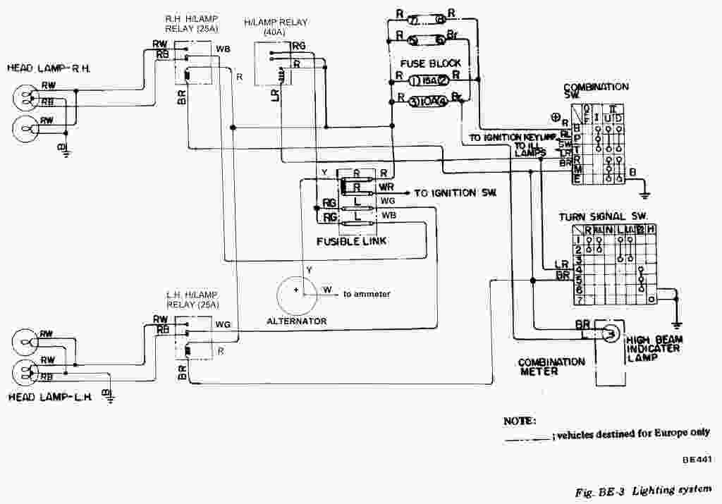

Headlight wiring is pretty basic as long as you understand that things are 'upside down'!
Essentially power is applied through the fusible link to a dual relay and from there to the switches.
The switches ground the appropriate part the relay which then grounds either high or low beam element(s) as required.
Two more fusible links also supply power to the common terminal on the lamp(s).
The catch is the column switches. Do you have two switches on the right side of the column? If so, does the one closest to the dash switch the lights on/off plus do hi/lo beam and does the one closest to the s'wheel do indicators plus passing beam?
I assume you do.
If that is the case then you can't easily change the headlight operation to a more 'conventional' arrangement without losing some functionality.
The best answer is to duplicate the factory arrangement out to but not including the relay. Use that wiring to switch relays and use the relays to drive the headlights in a conventional manner with earthed common and power applied to the beam when needed.
This also allows you to put semi-sealed beam halogen headlamps in without frying wires.
Get familiar with wiring diagrams by breaking it down into logical sections. Nissan even broke it down into smaller chunks already! Page BE-5 in the FSM is just the light wiring.

yep, i have the 2 stalks, exactly as you mentioned. I am glad you brought this up, as i was planning to run semi-sealed beam's and was planning to upgrade the headlight wiring to something beefier anyways (but i hadn't started my research on it yet).
i would love a copy of your diagram (maybe post here for future ref?)

If you want more lights on the front (like me!) then it's pretty easy to add wiring that satisfies the fuzz.
Add a 25A relay for each pair of 100W lamps.
Supply one side of the contacts in each relay from a new fusible link (a second assy from another K works nicely and can be fitted alongside the original for a 'stock' look).
Run wires from the other side of the contacts to the front of the car and connect the lamps.
ok, we'll assume two driving lights plus two fog lights.
Working with the relay attached to the driving lights. Connect one side of the relay coil to hi beam at the output of the hi-beam relay. Run a wire from the other side of the coil back to a switch in the dash or console. Wire the other side of the switch to ground.
Repeat this for the second (fog light) relay but this time connect to the lo-beam.
You can leave the switches both on and the fogs will run with lo-beam but not with hi-beam, the driving lights will run with hi-beam but not with lo-beam.
Switches off will kill the appropriate lamps regardless of beam selected.
If you get a sticky cop who insists on only 6 white lights on the front use amber fogs and then modify the parking lamp circuit so that park is earthed THROUGH the driving lights. In other words, what should be an earth for the park lamp now connects to the supply side of the driving lamps.
When the driving lamps come on with hi-beam the park lamps turn off ('cause there is now 12V on both sides of the globe) only to magically turn back on when the driving lamps are switched off!
