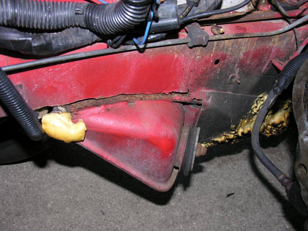

In the middle of engine rebuild and I am going through the engine bay, On the passenger side I see the rusted frame area. See Pic. What can I do to this? Is this something I can weld a patch to or is it really serious. I doesn't look good. I can shake the car and the split moves.

That's not good. The spray foam is a bad idea too as it holds moisture against the metal. I would say you are going to have to replace a lot of metal to do it right and I sure wouldn't drive it untill it was fixed right! You hit something with that right tire and it could fold right back.

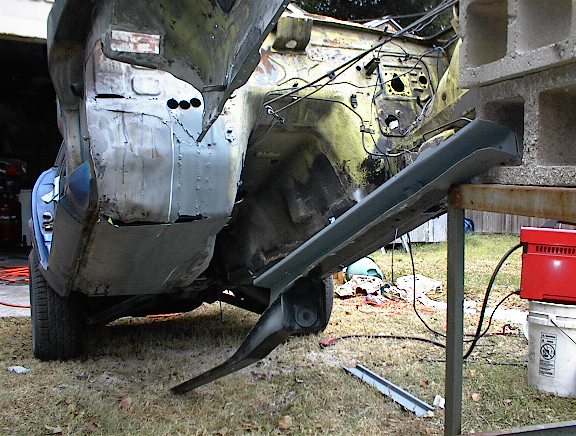

The attached pictures show passenger frame rail replacement. I had to cut out the battery tray and firewall material immediately around it because it was too thin to save/weld. You can see that my frame rail had the same tear as yours.
