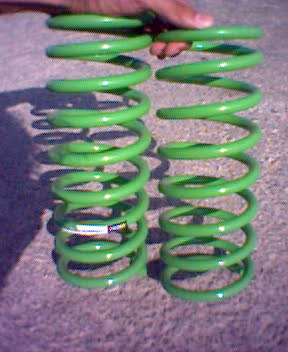

I ordered ST springs set for my '77 280Z and they safely arrived.. but the thing is that I noticed in the pictures that the ST springs come in grey color..
I received mine green?? is that right?
I attach a picture of the box and pir of front spring (with sticker) and a rear one..

From that tiny picture, they look green on the box as well. About the rubber spacer; I'm pretty sure you don't need one unless you're just trying to improve your suspension and not actually lower the car, but I'd ask one of the pros around here.
yeah you are right about the rubber spacer. I'm confused because one BM guy told me that all springs need that seed, while I don se this part in any z parts resourse!
I know that they share the same color as on the box.. but I saw them grey in internet..
who had same as those in GREEN?
Mine are 12 years old and are grey and thought I was getting blue, but they worked just fine regardless. When you install make sure you put on new bump stops, it helps with bottoming out, especailly with some of those roads you have over there.
