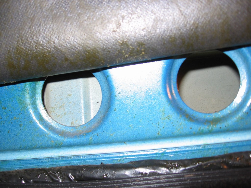

Posted September 30, 200618 yr comment_184265 I knew my car didn't have any significant rust and the rocker panels looked great outside, but this morning I had the interior vinyl off that area for the first time to run some wires. This gave me my first look at the inside of the rocker panels. I had thought there would probably be the beginnings of rust and figured I'd be poking my fingers in those holes with a brushful of Por 15. What a delightful sight I saw. I have attached one photo; excuse me if I seem to gloat. This is a California car, '73, spent its whole life in dry Pleasanton/Livermore till making the trip to my garage last December. Best, Steve Link to comment https://www.classiczcars.com/forums/topic/21753-rocker-panels-ah-what-a-fine-sight/ Share on other sites More sharing options...

September 30, 200618 yr comment_184268 I'd brag too if I had rockers that clean. Very nice.Zak Link to comment https://www.classiczcars.com/forums/topic/21753-rocker-panels-ah-what-a-fine-sight/#findComment-184268 Share on other sites More sharing options...
