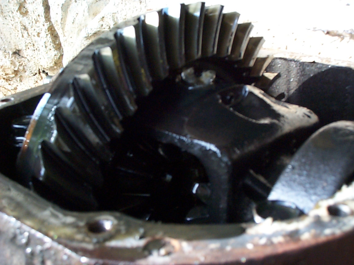

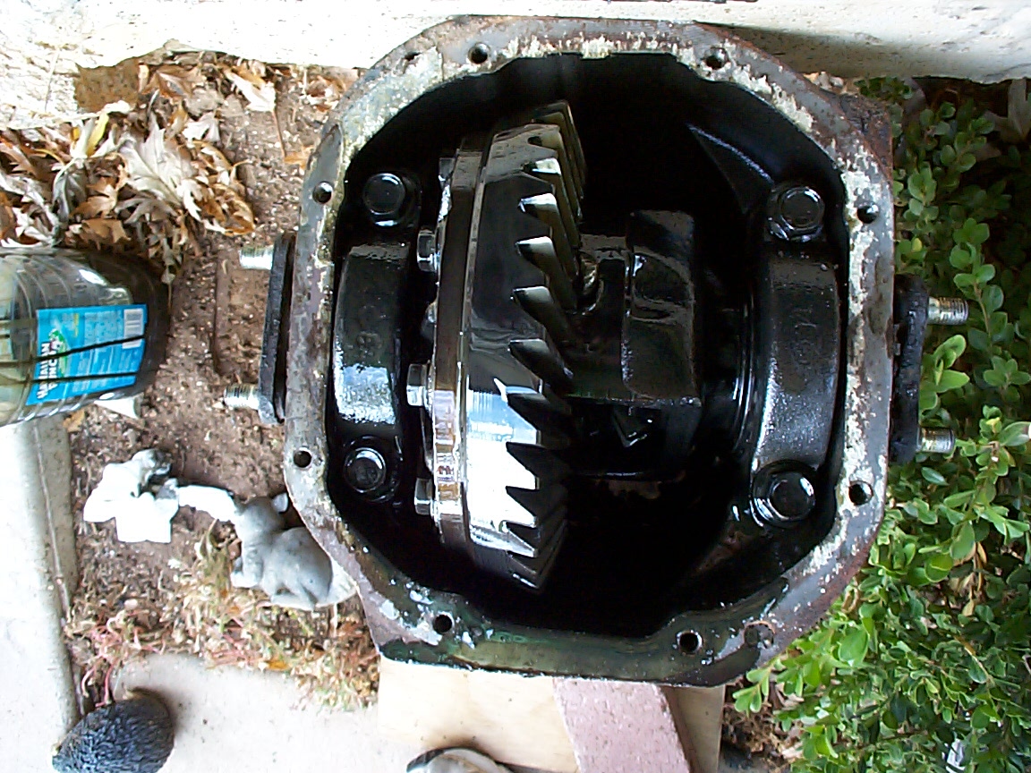

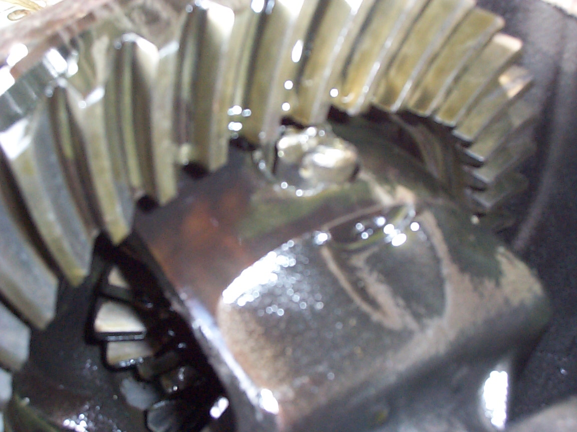

October 16, 200618 yr Author comment_186056 Thanks all for the input. Got the new one in and the old one out. I posted a few pics so you can see what I did to the old one. That little metal shaft thingy is busted. Idk what its called or what all else is broken, but it doesn't turn very smooth at all. Link to comment https://www.classiczcars.com/forums/topic/21813-easiest-way-to-get-the-driveshaft-and-halfshafts-off-the-diff/#findComment-186056 Share on other sites More sharing options...

October 16, 200618 yr Author comment_186065 jmortensen said: Sounds familiar... http://forums.hybridz.org/showthread.php?t=115404Only this dude has over 400hp and runs 11s. I am all stock with a tired old motor and I run 16s. Why me???? Link to comment https://www.classiczcars.com/forums/topic/21813-easiest-way-to-get-the-driveshaft-and-halfshafts-off-the-diff/#findComment-186065 Share on other sites More sharing options...
October 16, 200618 yr comment_186066 The fact that you know where you run at all probably explains it!! I don't think these diffs like drag racing... Link to comment https://www.classiczcars.com/forums/topic/21813-easiest-way-to-get-the-driveshaft-and-halfshafts-off-the-diff/#findComment-186066 Share on other sites More sharing options...
October 17, 200618 yr Author comment_186070 Arne said: The fact that you know where you run at all probably explains it!! I don't think these diffs like drag racing... Actually thats exactly why Im pretty sure i broke it when i ran it at the strip last October. Only 3 runs though Link to comment https://www.classiczcars.com/forums/topic/21813-easiest-way-to-get-the-driveshaft-and-halfshafts-off-the-diff/#findComment-186070 Share on other sites More sharing options...
