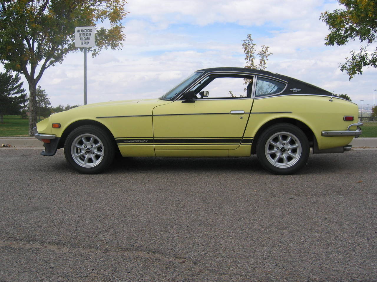

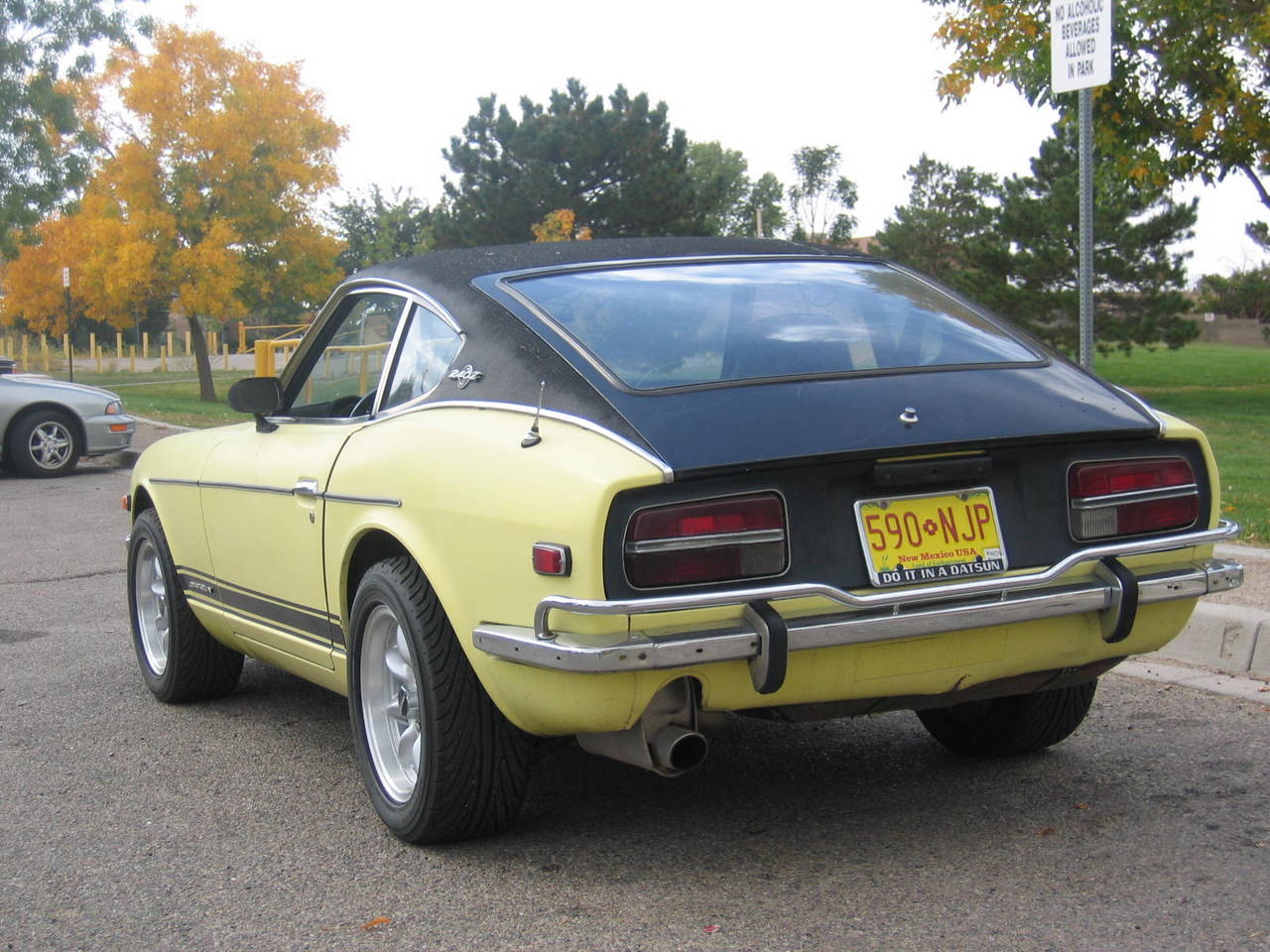

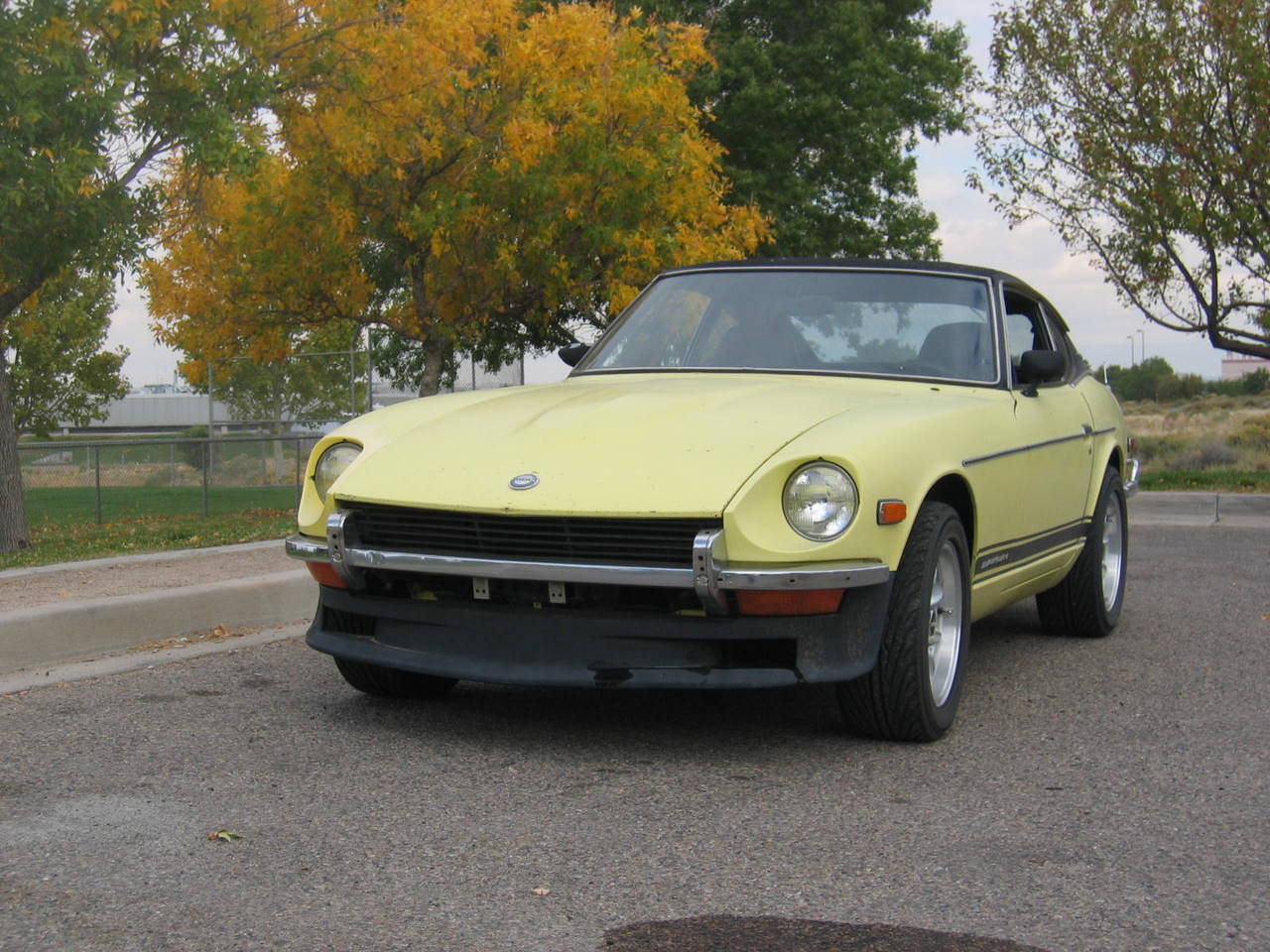

just personal preference I wanted a little wider in the back just for looks if nothing else. it does look nice with a fatter tire in the back. The car handles really good compared to the previous set up witch was 195/60/14 all the way around. I know some people will say it might hurt the handling but in my case it was a huge improvement. very happy with my set up

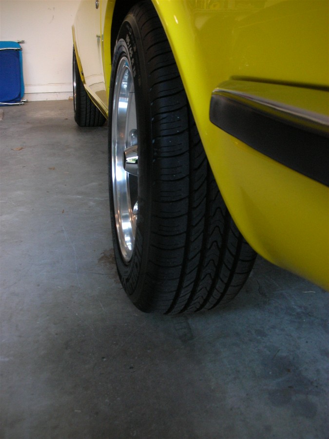

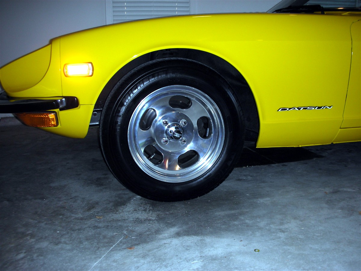

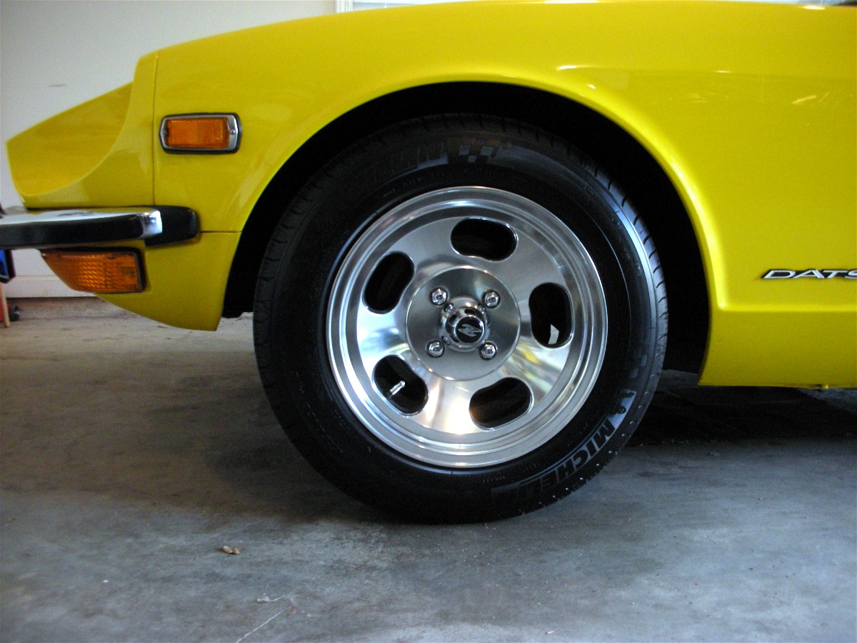

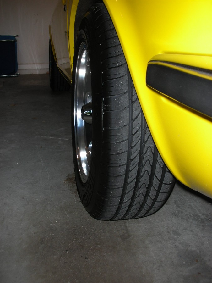

Arne,
My old tires (seen in my gallery) were 195/60/15, the new ones (seen below) are 195/65/15. Due to the age and treadware of the old tires, the diameter increased about .6/.7 inches or so. The tires seem to fit fine on the rims, here are a few photos (hopefully the side shot shows what you were after):
