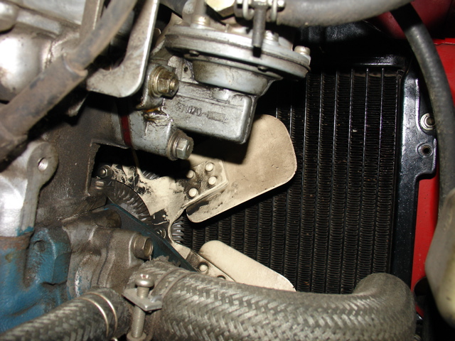

October 9, 200618 yr comment_185179 My red car is nearly original, and it appears to have a stud in the bottom hole. Link to comment https://www.classiczcars.com/forums/topic/21857-mechanical-fuel-pump-studs-tranny-drain-plug/#findComment-185179 Share on other sites More sharing options...

October 9, 200618 yr comment_185225 Hi Stephen. My car has 24,000 original miles on it. When I pulled the fuel pump last month the bottom bolt was plated with the zinc chromate finish. The pump had never been replaced according to my Father-in-Law who purchased the car new. Link to comment https://www.classiczcars.com/forums/topic/21857-mechanical-fuel-pump-studs-tranny-drain-plug/#findComment-185225 Share on other sites More sharing options...
