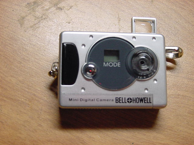

October 13, 200618 yr Author comment_185716 Thanks to Ricklandia, I got HanyAVI, and it seems to like my Bell & Howell credit card camera. I made a mount by GOOPing a short card-edge connector to the back, and forming a bracket from some aluminum ( it fits into the slot of the card-edge connector.) I'm in the process of mounting a mating bracket to the top of the heater panel area (which may double as a mount for a PDA), but I'm also going to make one that goes into the rearview mirror mount, and see which works best. On the subject of the Laptop (for recording the images,) vibration & bumps are of concern. Would a foam pad underneath be enough? Maybe just a soft blanket would be ebough. I believe the hard drive on a laptop can survive small bumps, but in the long run the odds for a longer, error-free life will increase if you cushion the laptop. So, I'll be making up a cushion from foam blocks by carning out notches for the laptop's corners to fit into, and the whole thing will be assembled together to fit into the passender seat somehow. thx Link to comment https://www.classiczcars.com/forums/topic/21889-in-car-time-lapse-photography-options/?&page=2#findComment-185716 Share on other sites More sharing options...

October 15, 200618 yr Author comment_185887 HandyAvi is just for capturing the images, and it allows you to replay the 'movie.' It doesn't actually control the camera, although some webcam software that comes with certain webcams, can. (like Logitec Quick-cam.) Link to comment https://www.classiczcars.com/forums/topic/21889-in-car-time-lapse-photography-options/?&page=2#findComment-185887 Share on other sites More sharing options...
October 15, 200618 yr comment_185896 HandyAvi is just for capturing the images, and it allows you to replay the 'movie.' It doesn't actually control the camera, although some webcam software that comes with certain webcams, can. (like Logitec Quick-cam.)What I meant was, does your camera have a windows driver that allows HandyAVI to "fire" the camera, much like it would if it were a webcam?I have a Nikon D70 at the office that I know can be fired via USB command. the other software I mentioned (MovieSalsa) I believe can sniff for specific file folders to "add" frames to a movie. this allows for the movies to be made automatically from a still camera. In fact, you can even tell it "make me a movie from 6am - 6pm..." and such. Link to comment https://www.classiczcars.com/forums/topic/21889-in-car-time-lapse-photography-options/?&page=2#findComment-185896 Share on other sites More sharing options...

October 15, 200618 yr Author comment_185902 What I meant was, does your camera have a windows driver that allows HandyAVI to "fire" the camera, much like it would if it were a webcam?The required driver is provided. No need to fire the camera's shutter. The camera is always on, and HandyAvi just captures the current image. From my experience, webcams are always on, and you deactivate them via the software. Link to comment https://www.classiczcars.com/forums/topic/21889-in-car-time-lapse-photography-options/?&page=2#findComment-185902 Share on other sites More sharing options...
