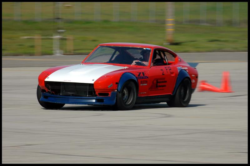

October 13, 200618 yr comment_185685 I used ZG's, they gave me heaps of room for wheel clearance. I know you don't like the look of screws maybe allen key bolts!? Pic below shows how much the wheel stck out prior to addition of the ZG's Link to comment https://www.classiczcars.com/forums/topic/21905-fender-flares-metal-fiberglass-or-carbon/#findComment-185685 Share on other sites More sharing options...
October 13, 200618 yr Author comment_185687 The car looks awesome! The shape and size of the ZG flares are perfect. I'd just like to achieve a uni-tone look. Maybe fiberglass is the only way to get that. So the question comes down to function vs. aesthetics. Link to comment https://www.classiczcars.com/forums/topic/21905-fender-flares-metal-fiberglass-or-carbon/#findComment-185687 Share on other sites More sharing options...
