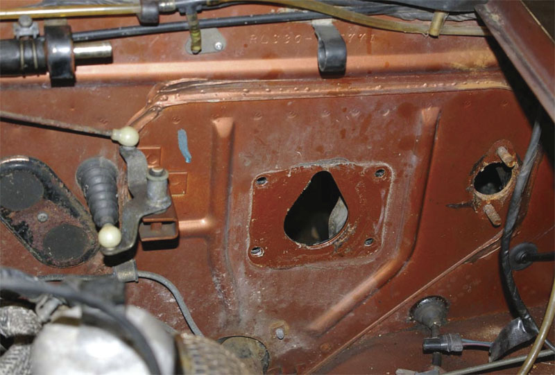

Good advice Bruce. After doing some zooming on a couple of the pictures more questions have come to mind as to what year it really is. In particular the photo that has the dash and console area in it. The dash appears to have a hole where the lighter would go and there appears to be a pin on the upper right side of the console in the area where the fuse cover would go. Which I assume would mean the fuse cover is hinged, which I am guessing the 72Z is. With this and what I have noted above, there may some fishy dealings here. Maybe someone in the past had a 72/73 that they used parts (LOTS of them) on this?

Series II cars entered production in Jan. of 71... and there were still a few Series I cars produced that month as well. So there were some crossover parts on the Jan. production cars... But not in 12/70 and not in the 17,000 VIN series that we had ever found...
So thanks really go to Enrique...
If you go back out to check the VIN stamped in the firewall - it's actually above and to the left of the brake booster on most Series I cars (but dzrt1st's picture is most helpful) .. and sometimes you have to pull the vacuum line aside... and clean the area to find it.
If it looks like it's been cut/pasted into the car (metal not matching up correctly or weld lines hidden around it etc) ... or it it's a different VIN - you'll know that something is out of wack... stolen maybe and VIN swapped...

So my best guess is that it is a '72 or '73 with a late '71 engine and the doorjamb VIN plate to match. I'd also love to know what the stamped VIN on the firewall says.
Probably can't blame the current owner, I'll bet that engine swap happened years ago.
Not sure if I will get the opportunity to get a photo of the VIN on the firewall or even get to look at the car again. Called the current owner and shared some of the thoughts here and asked if he had checked the VIN on the firewall yet (I had mentioned that to him last Friday or so) and he said he hadn't. I mentioned the price was a bit high and he got quite upset and hung up. So.....if he parts it out, as he did mention that today again, I hope he advertises, as I want some of the parts - if he is reasonable on pricing them.
