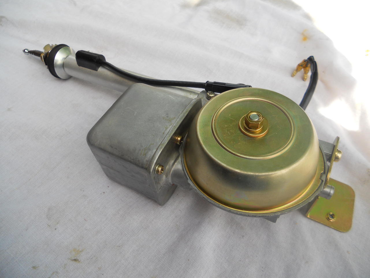

I finished the rebuild of an antenna for my car today complete with a NOS bullet tip mast (Thanks Dan!). One more project to cross off my list. I posted a thread on the rebuild if you are interested. http://www.classiczcars.com/forums/electrical-s30/49392-antenna-rebuild-restore.html
