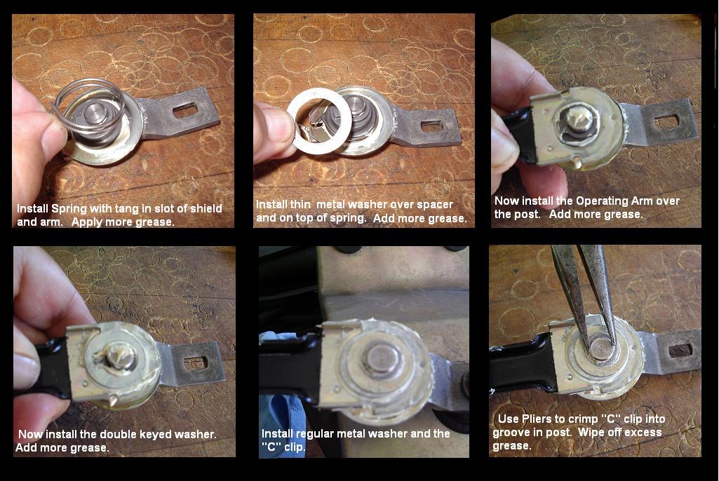

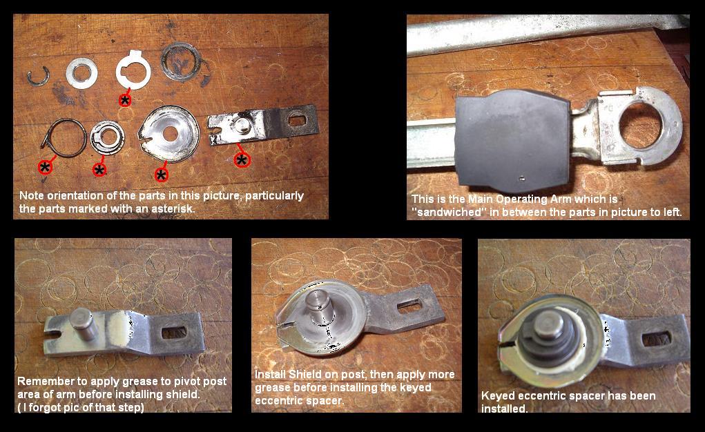

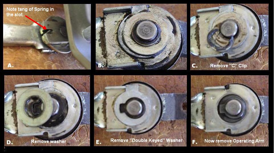

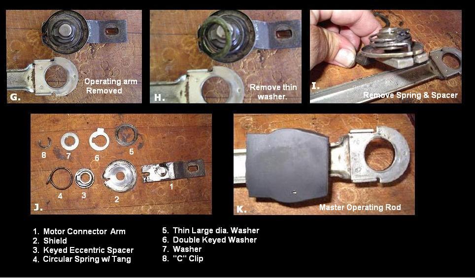

November 4, 200618 yr comment_188327 This might help you out some. Forget where I found them, but I stashed them away anyway. Figured I'd need them one day, somewhere down the road...If you know what I mean... webdawg1 Link to comment https://www.classiczcars.com/forums/topic/22159-new-parts-for-wiper-motor-attach-to-linkage/#findComment-188327 Share on other sites More sharing options...
November 4, 200618 yr comment_188329 The one Webdawg1 posted is the one I have found!!! As soon as I whipped out the digicam, the battery died. It is being charged as I type! Link to comment https://www.classiczcars.com/forums/topic/22159-new-parts-for-wiper-motor-attach-to-linkage/#findComment-188329 Share on other sites More sharing options...
November 4, 200618 yr comment_188330 Those are the ones that I *finally* found. Excellent work Webdawg!FYI:The first two are the disassembly process, pages one and two. The next two are the re-assembly process, again pages one and two.And, for the record, those pictures are from an article written by the Late Carl Stahlnecker, may he rest in peace, who could document articles beautifully. His articles and Dave's Gas Tank POR Renew are classics!FWIWE Link to comment https://www.classiczcars.com/forums/topic/22159-new-parts-for-wiper-motor-attach-to-linkage/#findComment-188330 Share on other sites More sharing options...

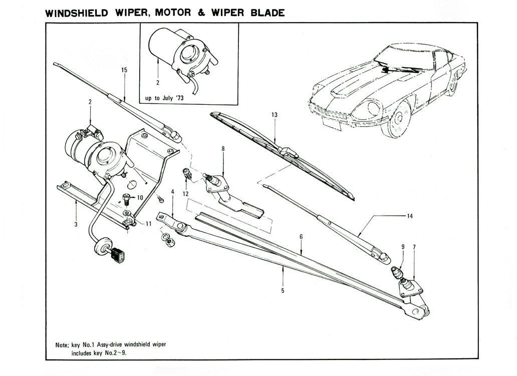

November 4, 200618 yr comment_188331 Sounds like he is making reference to item #4 and misc. washers...etc...etc in the following picture... webdawg1 Link to comment https://www.classiczcars.com/forums/topic/22159-new-parts-for-wiper-motor-attach-to-linkage/#findComment-188331 Share on other sites More sharing options...
