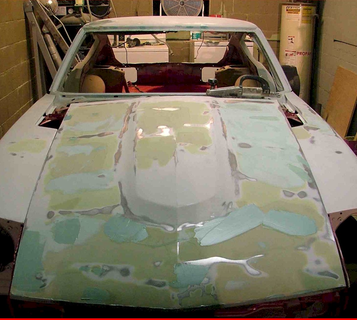

November 6, 200618 yr comment_188499 skyc110 said: first we prepair as much spare parts as the K needssecond the sandb. unfor nowadays enthusiasts went to paint remover instead !!! ummmm my advice (no one listen) that the sb. is better for stripping. QUOTE] Sandblasting works great except for panels that are unsupported can and often are warped by it. Sometimes this warpage is not noticable until the car is painted. A textbook example of this is my hood. Here's a link to a page I made which explains this further. I'm certainly not a Jedi master but I've learned a few things which might help so here they are... http://warbuddies.homestead.com/RestoHelp.html I sandblasted the underside of the hood then flipped it over to discover the nightmare I had created. This occured two years ago before I knew what the dif was between the siphon sandblaster and pressure pot. The pot is way faster BUT the pressure exerted on the metal distorts unless the metal is rigid or well supported. The siphon unit also distorts but to a much lesser degree it is also painfully slow. Most people can't perceive the warpage caused by siphon sandblasting. If you want a showcar finish and a dark color you will need to do some serious high build primer/sprayable polyester and block work if you strip panels by blasting. MHO (but semi-experienced O) Link to comment https://www.classiczcars.com/forums/topic/22177-how-we-restorate/#findComment-188499 Share on other sites More sharing options...
November 6, 200618 yr comment_188531 JimmyZ said: I sandblasted the underside of the hood then flipped it over to discover the nightmare I had created. This occured two years ago before I knew what the dif was between the siphon sandblaster and pressure pot. The pot is way faster BUT the pressure exerted on the metal distorts unless the metal is rigid or well supported. The siphon unit also distorts but to a much lesser degree it is also painfully slow. Most people can't perceive the warpage caused by siphon sandblasting. If you want a showcar finish and a dark color you will need to do some serious high build primer/sprayable polyester and block work if you strip panels by blasting.MHO (but semi-experienced O)that is a very good point to bring up, great link too.. lots to think about! Link to comment https://www.classiczcars.com/forums/topic/22177-how-we-restorate/#findComment-188531 Share on other sites More sharing options...
