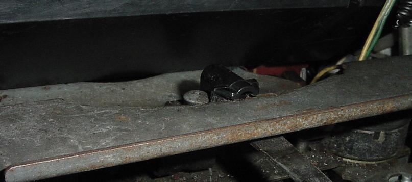

On my 280Z-
when you move the function lever for the heater, is it supposed to 'click' into the different stops for the different modes? ( vent, heat, biLevel, recirc) I think my controls are missing some kind of spring-loaded thing.
It would help to have a pick of the thing to maybe make the part- no help from the microfiche or FSM on this.
thx
TomoHawk,
From memory, there is a ball(BB) in that mechanism that provides the click. It sounds like your mechanism has lost one! It is held in compression by its interference fit. I have a HVac control from a 76/77 system out, tomorrow I will see if I can get a pic of it.
Will
Thanks Will,
I think there's supposed to be a slooted tube-thing on the end to keep the ball riding on the plate, and either a ball, or a rounded piece of rod in the end, held in place with a spring.
the pic would be very welcome.
thx a 10^6!
I'd be very surprised if the 240Z used vacuum to control the HVAC ducting. And since I've never seen a vacuum hose leading through the FW on my 73' I'd have to say that's extremely unlikely. I'm thinking more along the lines of a rusted control cable or pivot point. I've never seen one apart so I'm not sure what's in there.
Sounds like a control cable issue or a frozen door/valve to me to.
Take out your radio, follow the frozen cable to the other end, and you will have the answer. The cable system is easy and traightfolward to follow, just a little tough to get to(laying on you back in the footwell with safety glasses on is certianly not as easy as changing the spark plugs!!).
