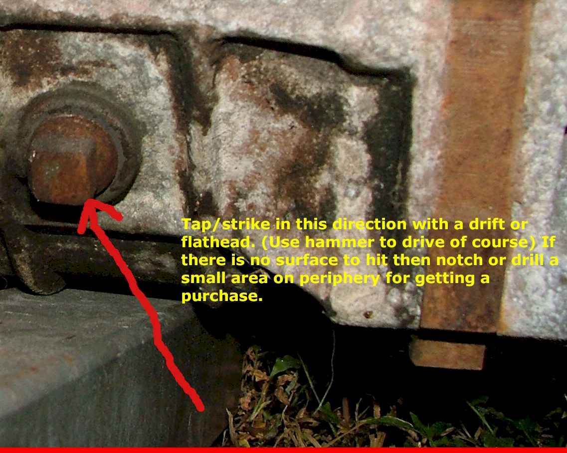

I'm assuming vise grips can't cut it for this one. As a last resort you can heat the tranny case with a torch which will make it turn easily. Ally will expand a thou or two at 300-400 deg while steel remains almost unchanged. Before torching try whacking the head of the plug hard as this can also loosen things up and also possiblt improve the gripping surface/head. (Hit straight on) I once heard of a crazy guy who took apart cars with a hammer. His principle was to tap the edges of fasteners with the hammer to turn them. You might be able to tap the edges using a screwdriver as your contact point. Heat the case with a propane torch then tap using a screwdriver driven by a hammer. Try the hammer tap trick w/o heating first.
One other option is to use a cutoff tool to notch a slot for a flathead screwdriver or piece of plate to nest in.
Having a bolt welded to the plug would be the last resort. As soon as the weld cooled the case would be hot/expanded then the bolt could be turned.

At any rate - to extract a stripped fill plug, you have to apply an outward force while turning counter-clockwise. Lock a pair of vice-grips on the fill plug, then put a prybar (old screwdriver) between the vice-grips and the tranny case..pry outward with the pry bar while you turn the plug. If your real lucky, once you move the plug outward a couple of turns, it may pick-up some good threads and unscrew the rest of the way..
