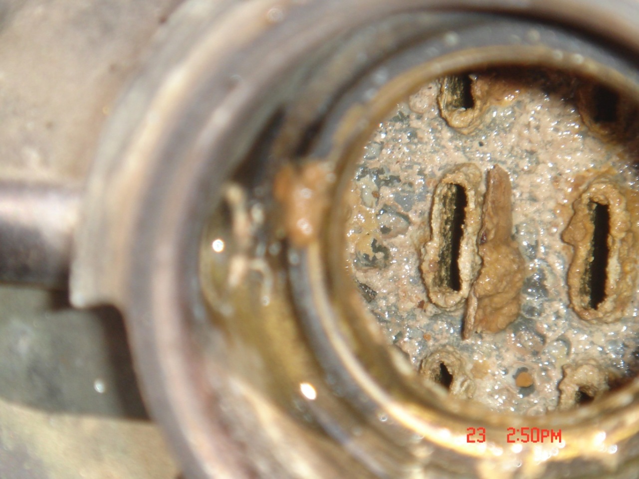

March 24, 200718 yr comment_203418 This is what is in my radiator. I'm trying the Prestone Super Cleaner (for neglected cooling systems). I'll update next week, after I've driven the required 3-4 hours. Link to comment https://www.classiczcars.com/forums/topic/22252-boiling-out-radiator/#findComment-203418 Share on other sites More sharing options...
March 24, 200718 yr comment_203427 Man alive David! That's some kinda ugly looking $hit coming out for sure!! I zoomed in on your picture and almost :sick: :sick: :sick: Please do give us an update on how this little experiment works out on your radiator. The before and after should be interesting indeed if it fixes this! Jim D. "Zup" Link to comment https://www.classiczcars.com/forums/topic/22252-boiling-out-radiator/#findComment-203427 Share on other sites More sharing options...

March 26, 200718 yr comment_203683 To my eyes, it looks like oil is getting into the coolant suggesting a blown head gaskett. Any chance you have been losing coolant or had other issues? What symptoms have you been having?Al Link to comment https://www.classiczcars.com/forums/topic/22252-boiling-out-radiator/#findComment-203683 Share on other sites More sharing options...
March 26, 200718 yr comment_203687 To my eyes, it looks like oil is getting into the coolant suggesting a blown head gasket.It does have that 'Cappuccino' look that usually denotes oil mixed with coolant. Link to comment https://www.classiczcars.com/forums/topic/22252-boiling-out-radiator/#findComment-203687 Share on other sites More sharing options...
March 28, 200718 yr comment_203919 Any chance you have been losing coolant or had other issues? What symptoms have you been having?I have been loosing coolant for a little while, first noticed coolant on several hoses, and sprayed up on the hood. It looked to me that there was a leak in the radiator, and that coolant was hitting the fan-then being sprayed. I was concerned that the water pump was the problem, but it has stayed dry as a bone, with no discernable green coolant marks, unlike the upper radiator hose.My original plan was to drain and clean the system, and try to find the leak. As a stop gap measure, I will be using bar's anti-leak stuff; however I didn't want to pour it into a filthy system. I check the oil fairly regularly, and haven't noticed it becoming creamy (water in oil), nor has it been dropping in level at a troubling rate (though it does burn some oil).I'll be draining the cleaning agent in a couple days, and will post photos of the results. I'll also try compression testing the cylinders, just in case the gasket is blown. Link to comment https://www.classiczcars.com/forums/topic/22252-boiling-out-radiator/#findComment-203919 Share on other sites More sharing options...
March 28, 200718 yr comment_203924 Whatever you plan to do to the radiator, and I would suggest having it recored, remember that the coolant passages inside the engine, including the water pump, are going to look just like the photo you provided of the radiator. Tom Link to comment https://www.classiczcars.com/forums/topic/22252-boiling-out-radiator/#findComment-203924 Share on other sites More sharing options...
