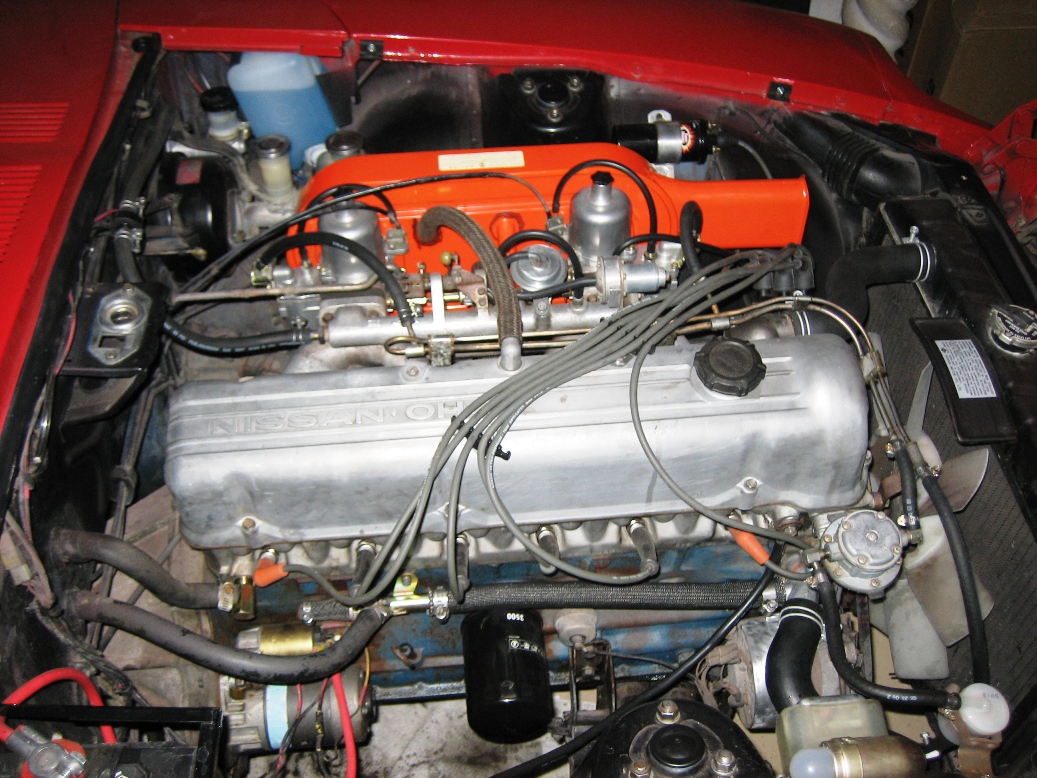

November 20, 200618 yr Author comment_190028 DatsunZGuy said: I am still running the original braided hoses (and numbered spark plug wires) on my car as well. Some of my hoses were starting to turn gray and fray at the ends, so I decided to fix it. The best technique I have found so far to restore them is to do the following:1. Wash with mild dishwashing liquid and hot water 2. Let dry for at least 24 hours 3. If the hose ends fabric is frayed, use clear Shoe Goo (this stuff is the bomb!) on the end to keep the fabric in place 4. Apply a couple coats of black Plasti Dip in the aerosol can to the hose and let dry Here is the result: Now the dilemma is my hoses now look restored, but can they be trusted on a long road trip? For peace of mind, I am considering switching to new hoses and covering them with Techflex braided sleeves. https://www.wirecare.com/wirecarephp1/wc_product_list.php?prod=FGN&prodline=ES That way, I have the reliability of new hoses and the braided look of the originals. The insultherm hose arrived and I had mixed results. Since it does 'expand' permanently a bit when stretched I found it didnt work well on hoses that bend. It is possible I bought the wrong size of insultherm. It really worked well on the pictured water hose (straight one just above the oil filter). Its tough to get clean ends since it is fireproof and heating has no effect. It is also obviously shinier than cloth braiding... Link to comment https://www.classiczcars.com/forums/topic/22264-refreshing-old-braided-hoses/?&page=2#findComment-190028 Share on other sites More sharing options...
