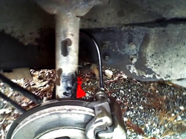

Well, I have brakes that work correctly, once again.

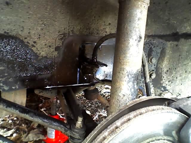

I had intended to rebuild my calipers, but the weather was working against me. After raining all night long, I took advantage of a semi clearing day, minimal drizzle, and just a touch of snow. Luckily, the snow didn't start until I was on the 2nd wheel (passenger), and even then it didn't snow much. Replacing the brake lines wasn't too hard, especially since I had heeded the advice about getting flare wrenches and PB spray lube.
I had never bled brakes before, for that matter, I'd never messed with any brake component to any real extent before last week, so I took everything slow, and reread the FSM several times.

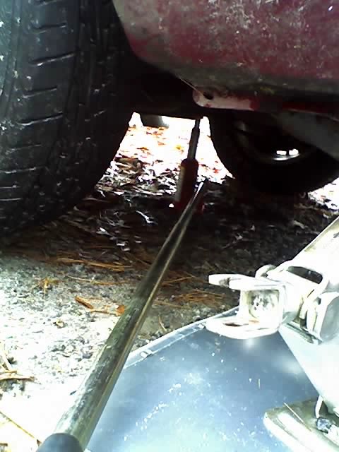

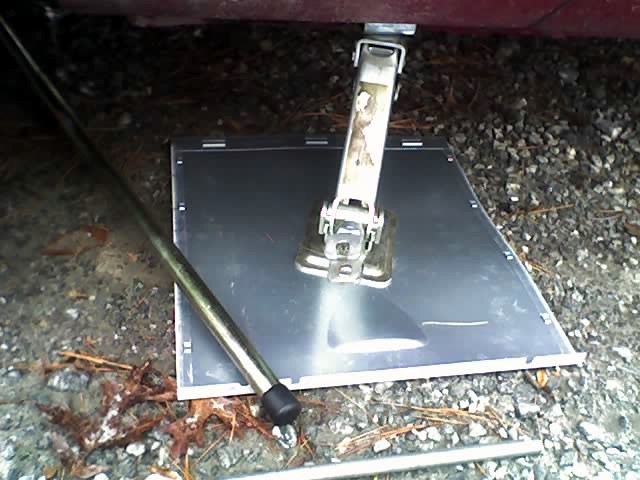

My drive is gravel, and it's tilted. I was worried about jacking up, so I improvised. I took the hydrolic jack from my Montero and used it in conjunction with the Nissan jack. I have a "dead" computer, and I used a side panel as a solid foundation. I would jack one up, then the other. I blocked both rear wheels with some rather large rocks, and went to work.
After installing the new lines, and bleeding them, I hopped in the car, only to find that I had no brakes whatsoever. I called the mechanic shop that I use for major work and they told me that I had to bleed all four brakes. :stupid:
Live and learn, I guess. Anyway, I still have a little bleeding left to do, though I'm going to get some help for this round of bleeding. My skateboard assistant did a great job at first, but as the pressure built up, it wasn't able to stay locked on my seat.

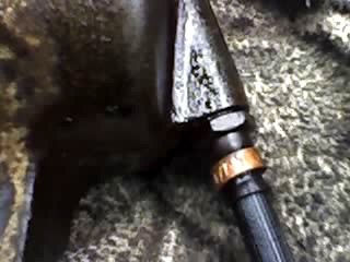

The brake lines were original equipment, marked 3/79 on the hose, with a copper ring marked 4/79. If anyone wants them for any reason, pm me. I wouldn't reinstall them, since they are no good, but perhaps a collecter of all things Z might want them for reference or some such.

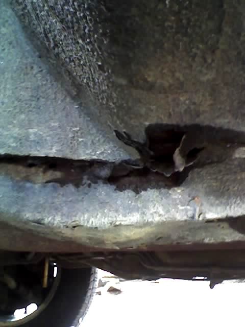

The last photo is rather irritating. It's a hole on the drivers floorpan, just another thing to fix when it get to those frame rails...
David, glad you've made progress, and it sounds like you're close; the skate board is creative :) but not a substitute for a human leg.
Perhaps it's just the color in the picture, but the color of the disc doesn't look right. I can't tell if that's from overheating, or corrosion, or perhaps something else, but "it no look right".
Also, I didn't see any jack stands. Forgive me if I sound like a parent (which I am), but that's just not safe, even with 2 jacks. Any time you are going to put any part of your body under a car, there needs to be a jack stand. Don't let yourself get in the habit of making excuses, even if it's only for a minute. Jack stands are cheap, and a lot cheaper than the visit to an emergency room or worse. Sorry for the lecture, glad to see you jumping in on something new, and please be safe.
Daniel, you're absolutely right about the jack stands, it's on the list with a nice floor jack. The passenger side disk had some surface rust on it, I think that's the one you are commenting on, and the color doesn't look right because I was using my cell phone camera, not the best quality.
ditto on the stands. never trust a jack alone.

Another thing that's good to do is to put the wheels under the car. I do it even when I've got the car up on jack stands....that way, if things go south in a hurry, at least i won't be crushed under the car.
I've had a car slip off the jack, a minute or so after I came out from under the car, and that is scary stuff....
