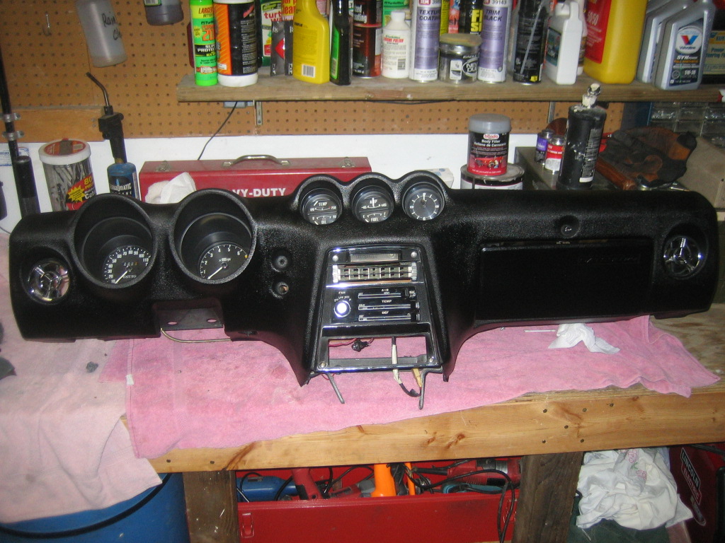

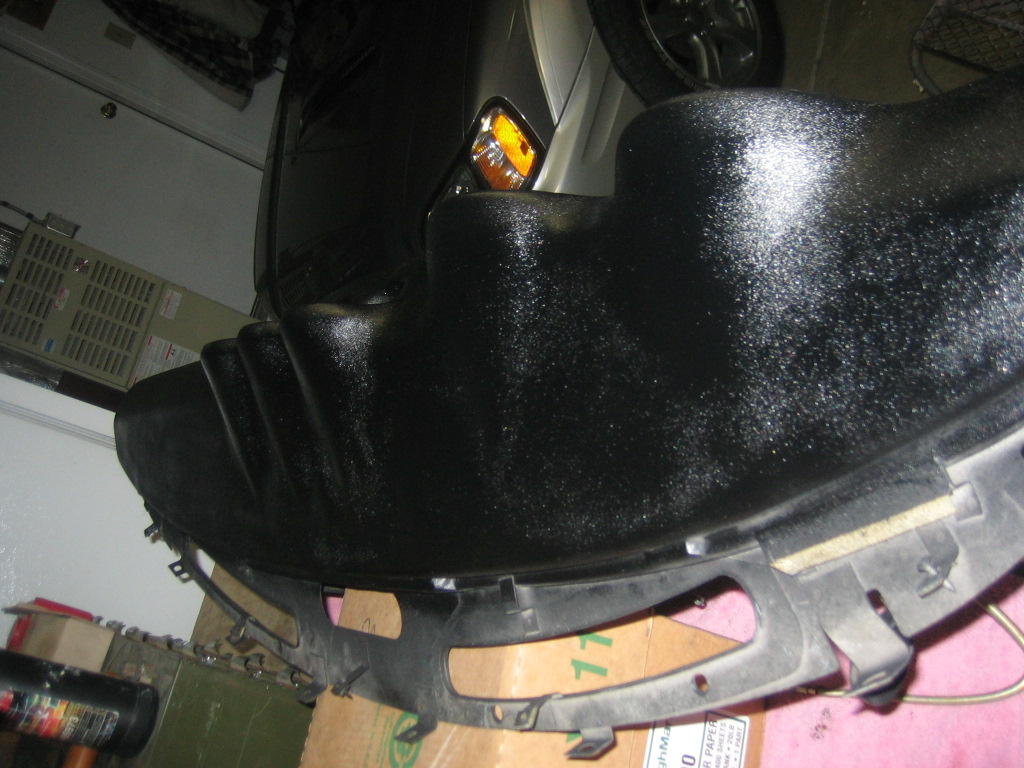

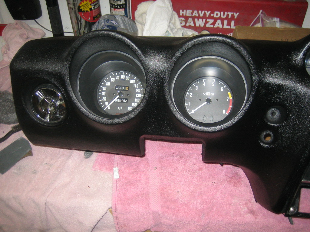

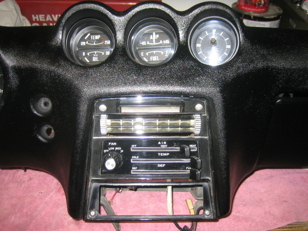

Pretty much have finished my dash resto and I am happy. I used the NAPA repair stuff and finished color was duplicolor vinyl black. The duplicolor has a lot of shine so I should only have to wipe off with rag when it gets dusty. Only thing I wish I did better was the sems texture paint. Don't try outside if there is any wind since you have to hold 20" from the object your painting. I was able to sand it until it looked pretty uniform. I will happy if it does't crack and if it does it will be cover time. I spent a lot of time polishing the chrome and I was pleasantly suprised how well the chrome came back to life. Use some 00steel wool and you will be amazed how well you can get the finish back. I also polished all the gauge plastic. Here are some pics
