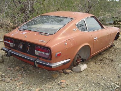

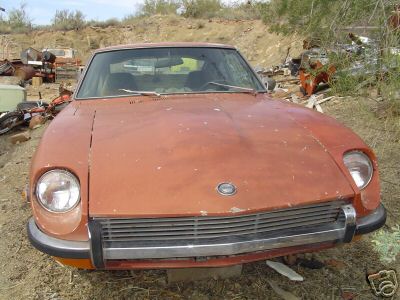

June 18, 200915 yr comment_287080 Guy, Yes, your '70 is truly an incredible car and I'm not surprised that she takes 1st place in every show you've entered her! From a neglected old car baking in the Arizona desert (see pics below) to multiple award winner, she certainly has come a long ways! I'm sure Bruce is also proud of her as well. I saw your thread with the pictures of the L28 -you did an incredible job -the engine looks absolutely beautiful and I'm sure that it runs great too. I look forward to seeing the pics of you '71 product once it's finished. Link to comment https://www.classiczcars.com/forums/topic/22325-dash-repair-processpictures/?&page=8#findComment-287080 Share on other sites More sharing options...
June 18, 200915 yr comment_287124 Steve.....Thanks for all of your kind words.......Bruce gets credit for this resto.....wait till you see the 71......it'll blow you away....I'll take credit for that one. Link to comment https://www.classiczcars.com/forums/topic/22325-dash-repair-processpictures/?&page=8#findComment-287124 Share on other sites More sharing options...

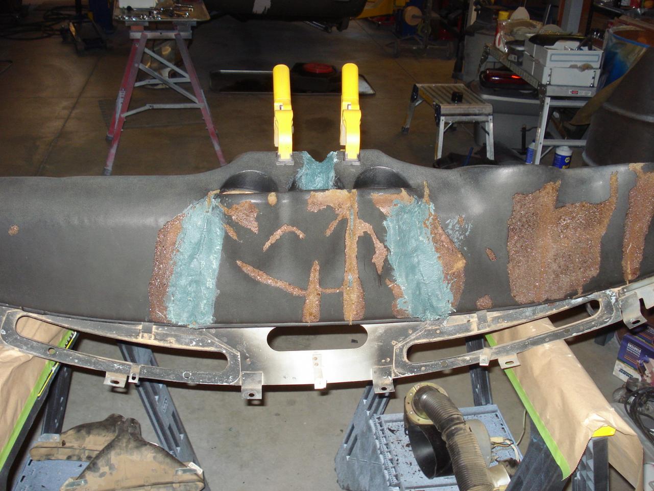

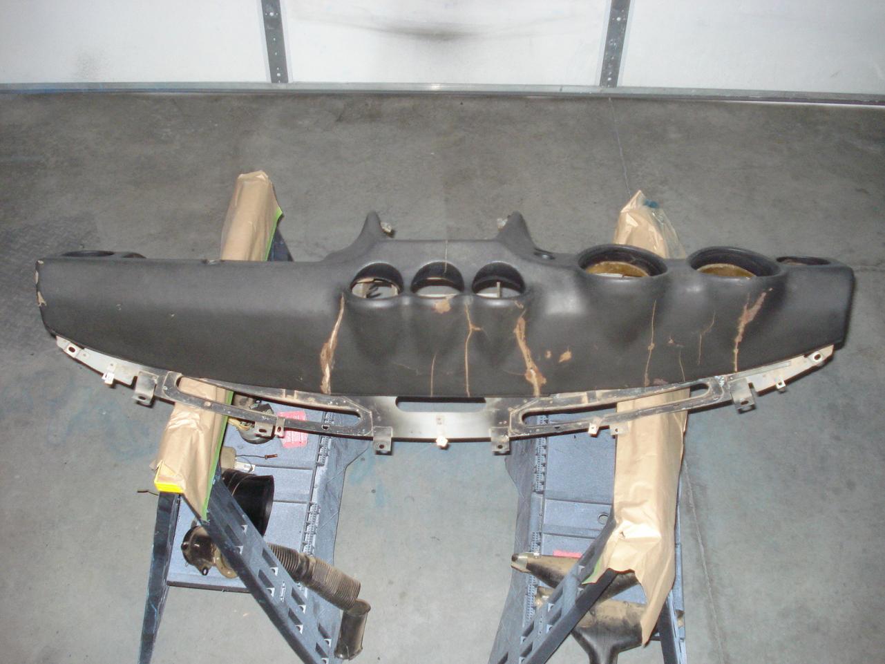

December 29, 200915 yr comment_304471 I'm in the process of attempting this procedure myself. However, now that I have my dash out, I've noticed a particularly weak spot above the center of the three small gauge slots. If I were to use flexible bumper repair below the dash foam and reinforce with a fiberglass square or two, taking up about a 3" by 3" area, would that be an effective means of protection? Link to comment https://www.classiczcars.com/forums/topic/22325-dash-repair-processpictures/?&page=8#findComment-304471 Share on other sites More sharing options...

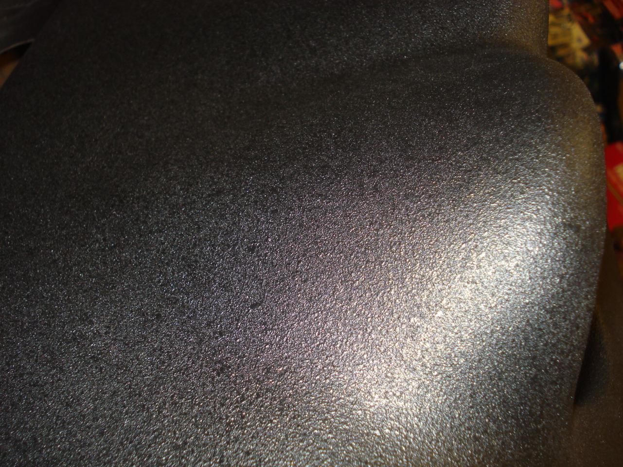

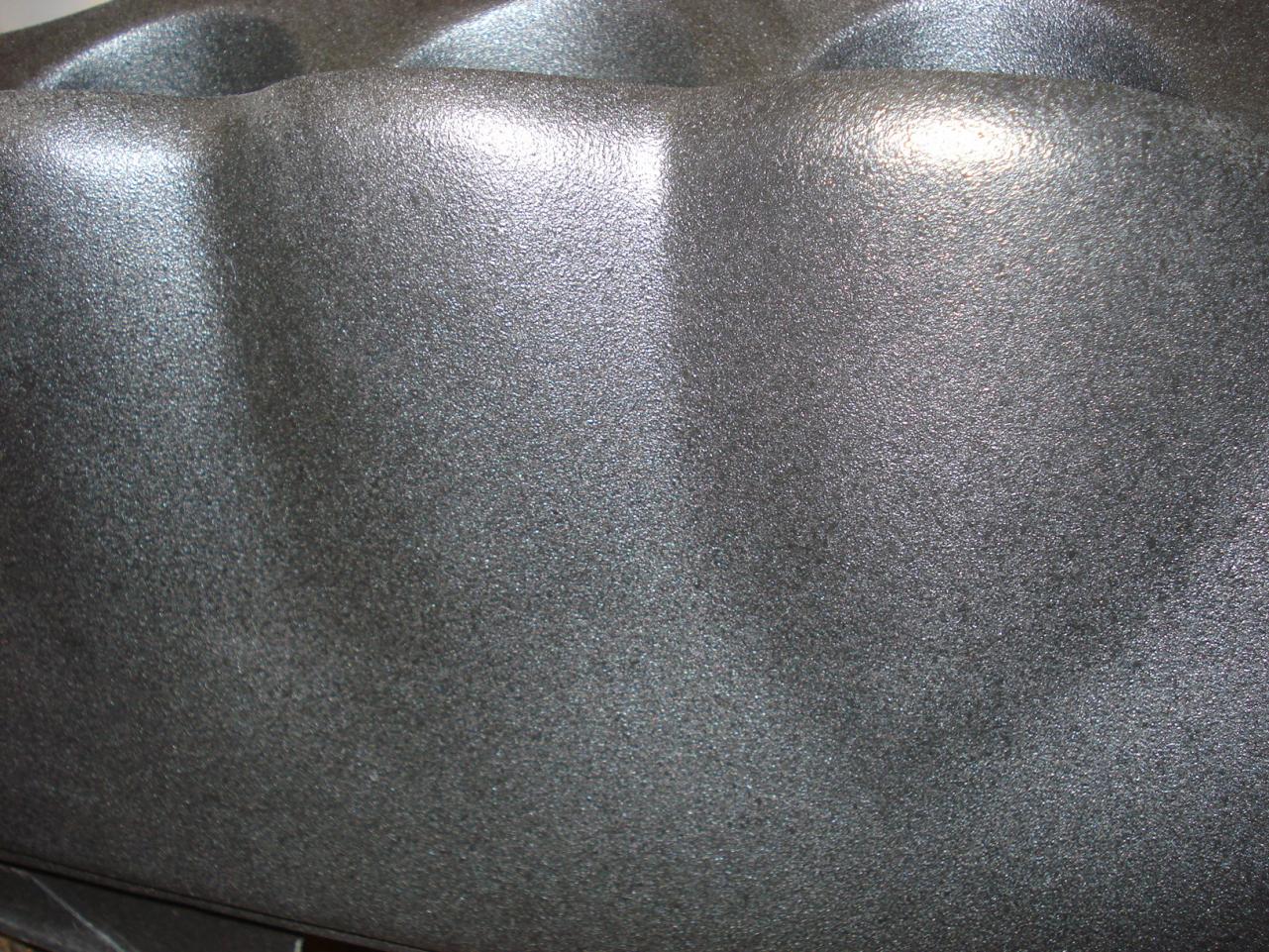

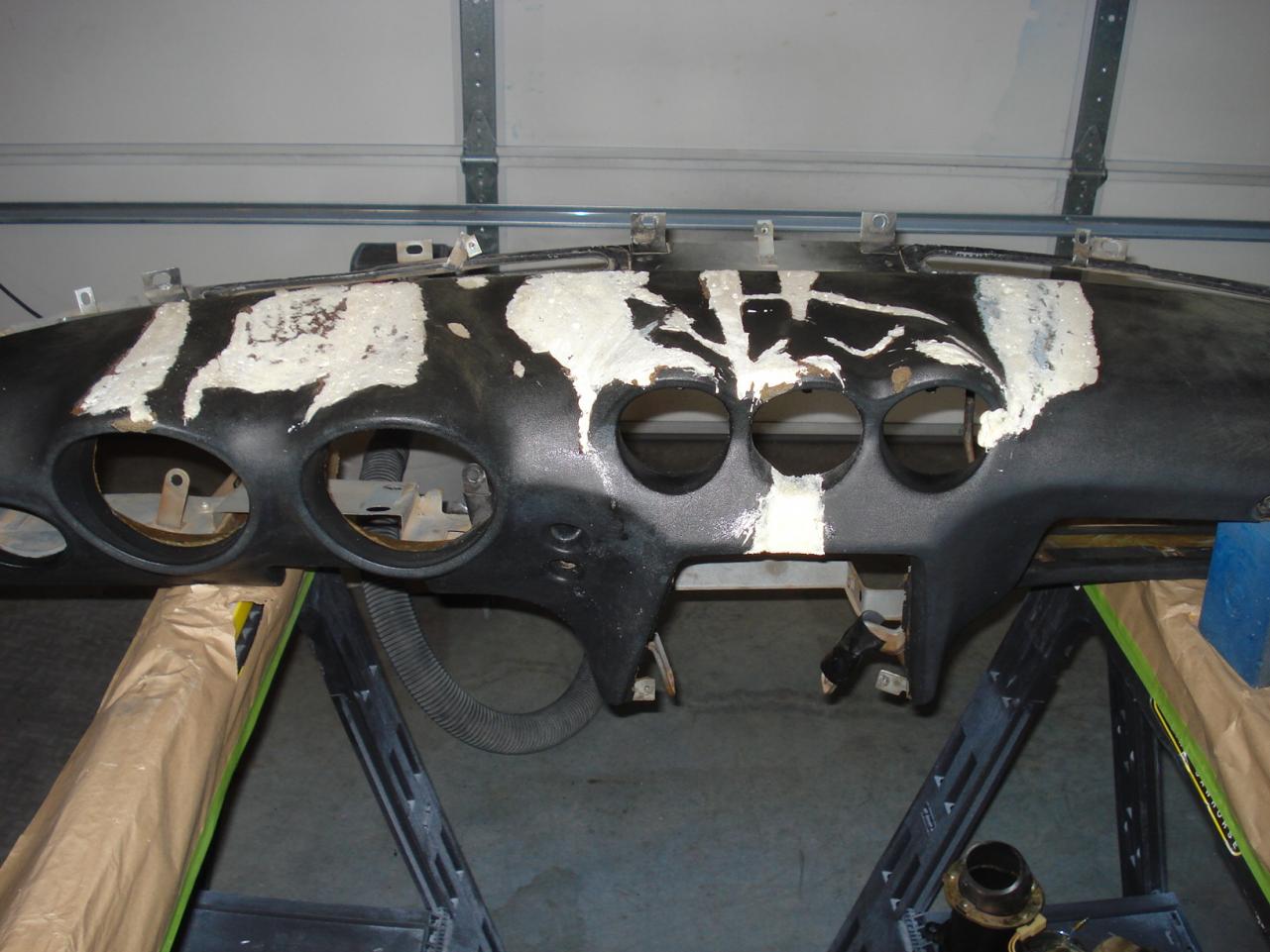

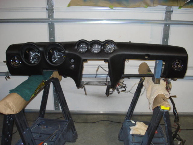

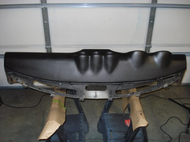

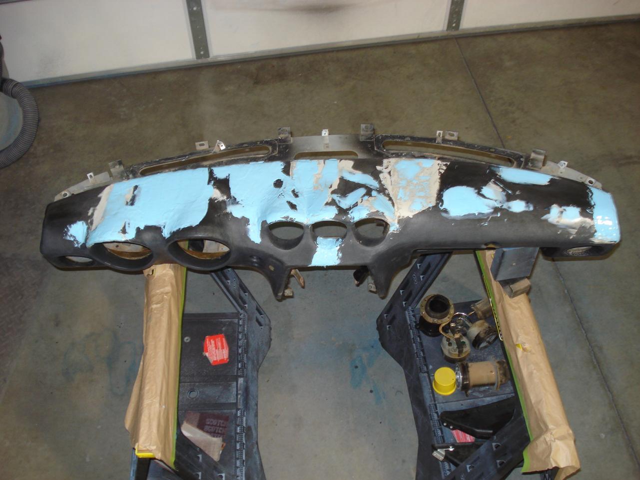

December 5, 201014 yr comment_337962 I recently repaired the dash in my '71 using the process initially described in this thread. I started by repairing the deepest cracks with fiberglass. I then filled the cracks and low spots with the spray foam and cut it down with a hacksaw. I began covering the cracks with the SEM bumper repair epoxy, but soon ran out. Too many cracks! I switched to the NAPA bumper repair kit. In my experience, I'd say the NAPA epoxy is easier to work with. The NAPA epoxy has a slower cure time, which allowed me to mix up bigger batches and cover more of the cracks at a time. Both products seem to provide a similar flexible coat when cured. I ended up spraying the dash with Duplicolor truck bed liner. It provided a grainy finish with a nice semi-gloss finish. There was no need to spray it with the SEM trim black afterwards. I think it turned out pretty good! Link to comment https://www.classiczcars.com/forums/topic/22325-dash-repair-processpictures/?&page=8#findComment-337962 Share on other sites More sharing options...
December 5, 201014 yr comment_337965 Outstanding. After all is said and done I'm sure you saved over $750 from what the "pros" charge. You'll have a lot more pride in your result then from writing a check. Link to comment https://www.classiczcars.com/forums/topic/22325-dash-repair-processpictures/?&page=8#findComment-337965 Share on other sites More sharing options...
