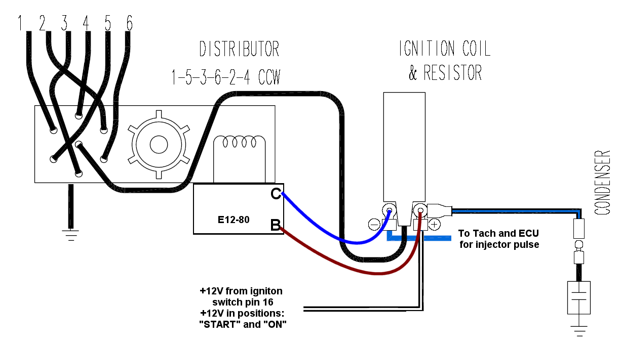

I diconnected the battery, removed the number 1 plug used a piece of new clean gas welding rod to verify #1 TDC, noted position of rotor with cap off.
undid the two bolts pulled up. set aside. inserted new used dizzy from zx its impossible to really get it on there bad. as the key way wont line up. installed brand new cap. transfered wires Firing order same.
Did wiring alterations as per attached Schematic Accept that that blue wire only goes to the tach and not an ecu.
