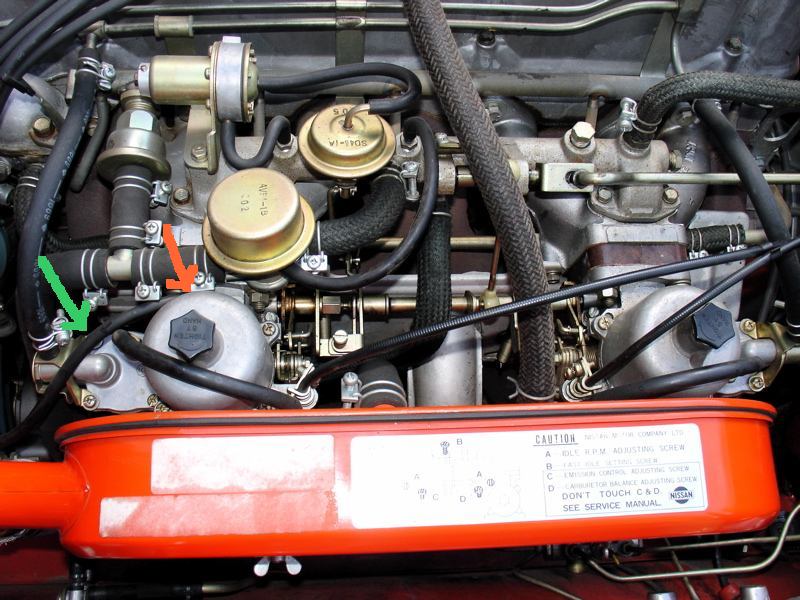

I attached a picture of my car's engine, which is complete with all the emissions gear. I noted the vacuum advance hose with a green arrow. It's hard to see where it connects because it's hidden by the carb, but I pointed it out with an orange arrow.

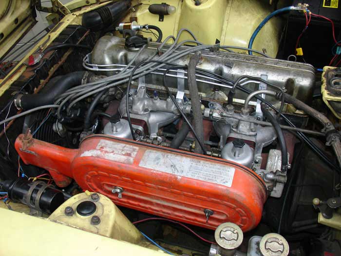

I also attached a more typical picture of my other car's engine. It's not as clear but does show the lack of smog gear and the plugged nipples on the balance tube.

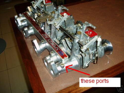

I've been looking at this very same problem. I'm going triples on my 2.4. The manifold is drilled and tapped at every runner, I think to make use of carb sticks, the mercury vacume tube set up for balancing mulit carbs like on motorcycles. If I were to link these vacume ports together would I get the same result as the vacume setup off a regular carb set up?
