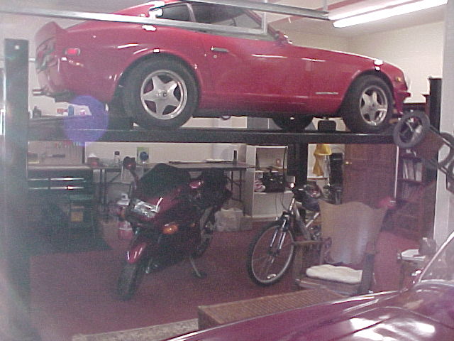

I got a metro lift 7000 series last year and have really enjoyed it. Just about everything I do on the car is much easier and more pleasant. It feels very secure and I have no qualms about parking another vehicle under it.

I debated the two styles and finally chose the four post version because it made me feel more secure about vehicles parked in the bottom slot and I didn't need to anchor it in the floor. In fact, my lift has removable (enormous) wheels that allow me to move it around -- even outside. I was also attracted to the ease of getting cars on and off on the ramps. On the other hand, it is very hard to use with jack stands so work on the wheels is usually done the old fashioned way on the floor. For everything else, including lifting other stuff like lawn tractors to a convenient working height, it has been as functional as I had hoped. Bottom Line: The style is a compromise, but it works for more things that I need to do.

The design is very solid with guides inside of the posts that prevent racking. It comes with floor bolts and I was initially tempted, but it is solid as a rock.
Ceiling height is a problem. My garage cieling is 10' 2" and I can only lift my 240z's wheels 5'7" off the floor. It would be very limited with an 8' ceiling. The lift has mechanical locking tabs on the legs forcing you to lift beyond your resting point and then lower down on the tabs making the 8' ceiling even more problematic. I have caution and stop points marked in day glow on the post adjacent to the hydraulic controls, so it is pretty easy and quick for me to get it into position.
The garage door height is more of a problem. If you look at the picture, you'll see that the door rails are about hood level when the car is raised. In order to lift the door high enough to bring a car in the lower slot, the top car has to be moved all the way away from the door (and the lift was also moved in that direction). This is annoying and has caused banging of the top car with the door more than once -- I now have a removable stop on the door rail to prevent me from forgetting this limitation of two objects occupying the same space simultaneously.
I have really large carport on the side of the garage that has much higher ceilings (15'-16') and my next project is to enclose it, install a much taller door, and move my lift to its new home where I don't have to worry about these things. Of course, Carl's correct observation about the current door height and the additional height when the lift is raised on its wheels will require partial disassembly of this incredibly heavy piece of equipment (original assembly of the main rails took four very burly men), but it will be worth the effort for my peace of mind.
I've wanted the convenience of a lift for most of my life and kept postponing because of the expense and concerns about use. I should have gotten one a long time ago. I use it for everything - you haven't lived until you have detailed your wheels with your car at exactly the correct height. This is a truly great tool/toy!:laugh: :laugh:
