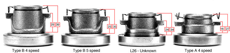

There are three or four different lengths of throw-out bearing collars.. The shortest is used with the older 240-Z Pressure Plates... the medium and longer one's are used with the 280Z Pressure Plates..
The problem you describe - would indicate that you need the longer throw-out bearing collar.. If you don't have access to a good junk yard - you'll have order the part from your Local Nissan Dealer..
Is the clutch assembly you purchased - an OEM Nissan Part? It it is, you should be able to find out what year/model it was originally specified for (ie not superceded by) and then order the matching throw-out bearing collar. If the clutch assembly is aftermark - you might have to try a couple different throw-out bearing collars...
This picture was on Eric's site... but I can't find the URL for it again..
