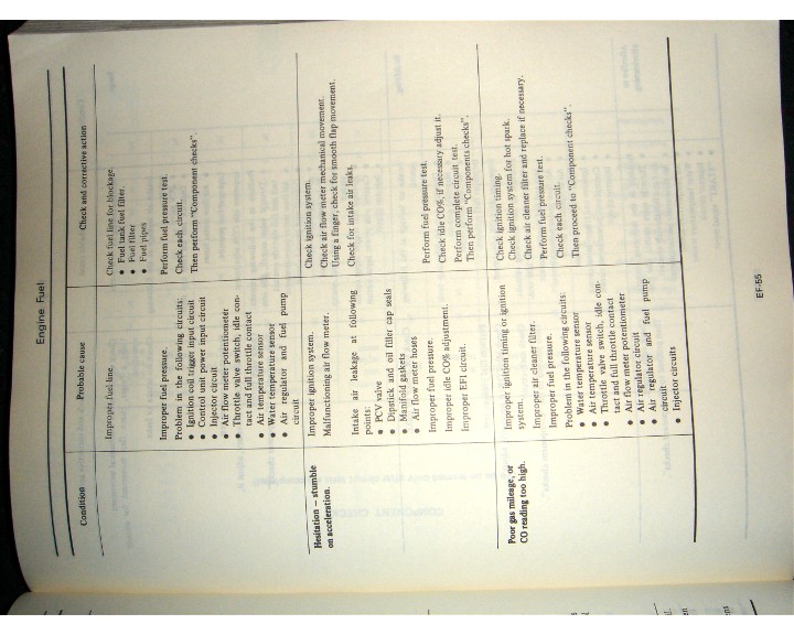

Because of the cam I chose, I always let the car idle for a minute or two before driving it, so that has not changed. Once of the things that stood out to me from zbane's reply was the "air temp sensor." I may need to dig up the diagnostic for it in my FSM.
