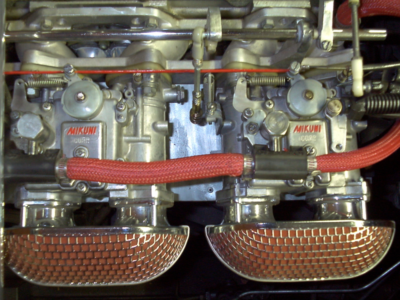

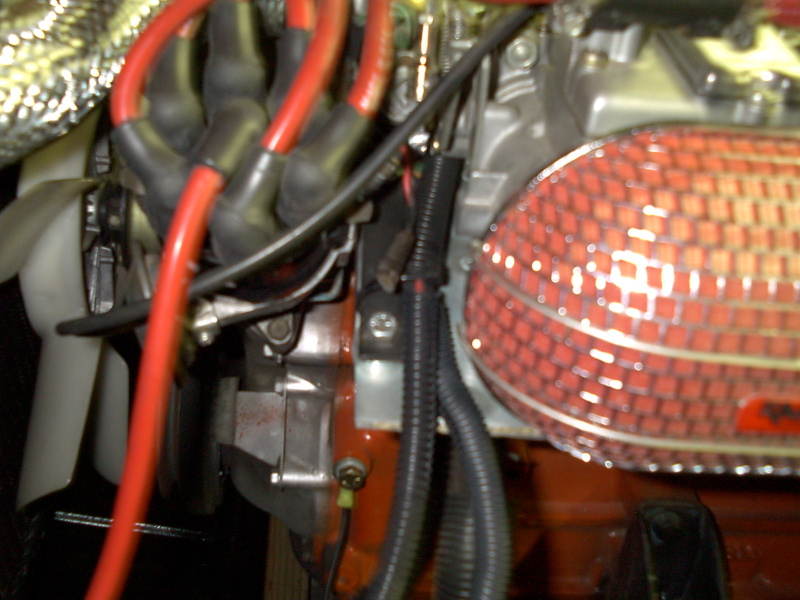

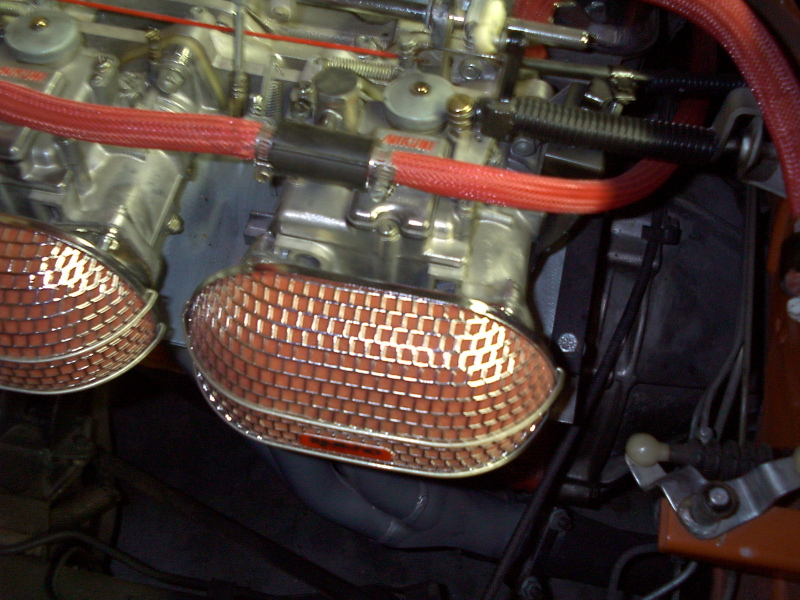

December 13, 200618 yr comment_192500 Here are ZIIIs (Georges) pictures. Will Link to comment https://www.classiczcars.com/forums/topic/22586-heat-shield-for-triples/?&page=2#findComment-192500 Share on other sites More sharing options...
December 13, 200618 yr comment_192505 Thanks Will.... Am still trying to figure the photos out. Never had a problem before... One of those weeks I guess.... Link to comment https://www.classiczcars.com/forums/topic/22586-heat-shield-for-triples/?&page=2#findComment-192505 Share on other sites More sharing options...

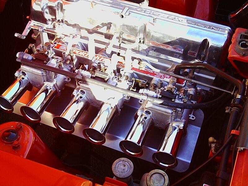

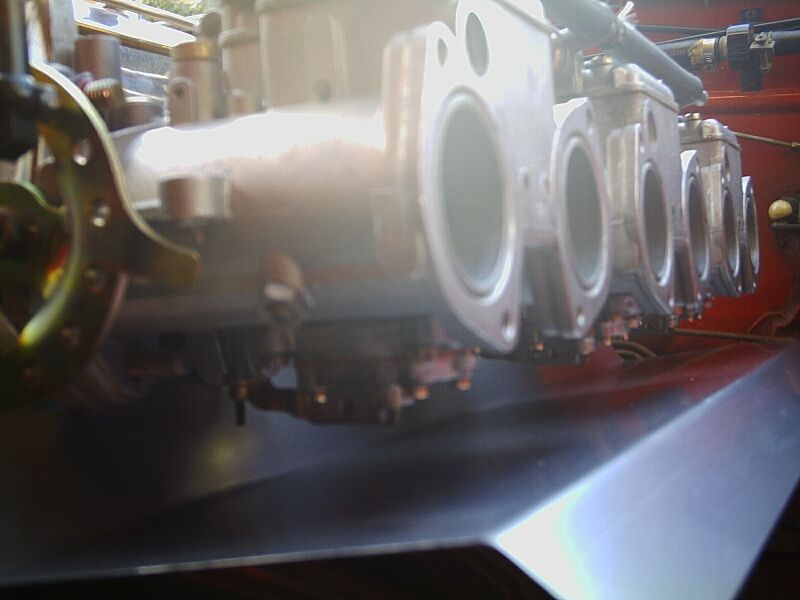

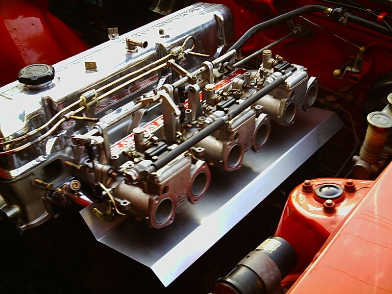

December 31, 200618 yr Author comment_194349 Well, this is what I have come up with. At the carb base, I have bent the shield up under and behind the manifold flanges to stop heat transfer to the back of the carbs. I had to keep some space under the carbs due to the accelerator pumps. The shield mounts off the bottom carb studs. I did this one out of stainless and I might add a thin ceramic insulator pad to the bottom side of the shield. Link to comment https://www.classiczcars.com/forums/topic/22586-heat-shield-for-triples/?&page=2#findComment-194349 Share on other sites More sharing options...
December 31, 200618 yr comment_194351 Very nice job.... You may be able to get away with not adding some sort of insulation, however, after I added another barrier it really helped. Link to comment https://www.classiczcars.com/forums/topic/22586-heat-shield-for-triples/?&page=2#findComment-194351 Share on other sites More sharing options...
