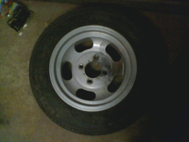

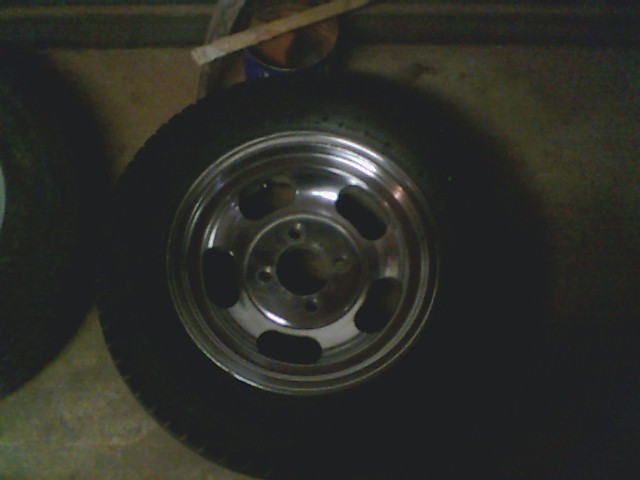

Posted July 14, 200222 yr comment_10519 i really want to get my rims all super shiny without the expense of chroming. I know with the right buffer and rubbing compound it could be done...just need to know if anyone has done it yet and what products did they use? Ive got the slotted mags on there right now. Link to comment https://www.classiczcars.com/forums/topic/2261-polished-rim-s/ Share on other sites More sharing options...
July 14, 200222 yr comment_10523 before Link to comment https://www.classiczcars.com/forums/topic/2261-polished-rim-s/#findComment-10523 Share on other sites More sharing options...
July 14, 200222 yr comment_10524 after Link to comment https://www.classiczcars.com/forums/topic/2261-polished-rim-s/#findComment-10524 Share on other sites More sharing options...
