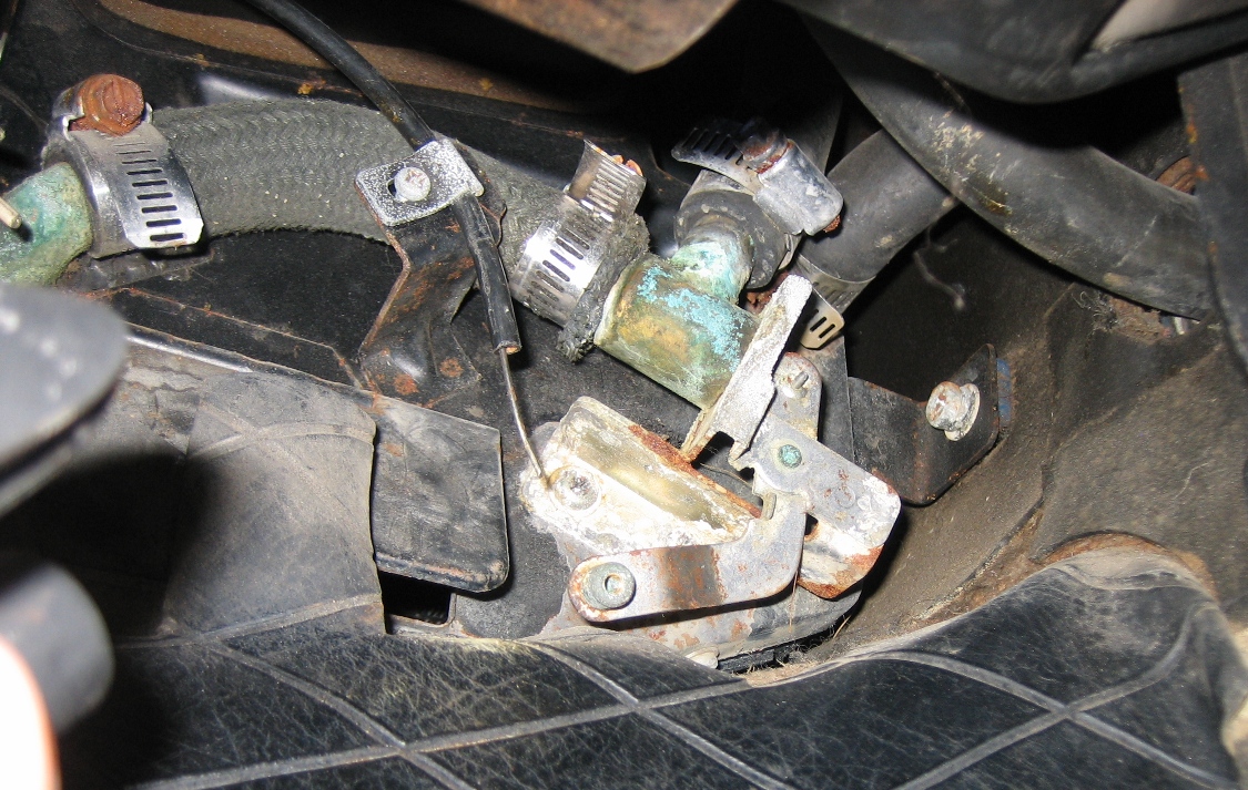

I am trying to replace the heater hoses with some nice braided hoses I just bought, as well as the control valve.
In addition to being in a brutal place to work while twisted up under the dash, the screws that hold it in place were so stripped out by the PO that the philips head is how a mangled mess.
As you can see from the picture, things are corroding in there so I really want to replace the valve while I am there...
Any ideas how I can get these screws out in such cramped quarters? I can just get a screwdriver on it but no amount of torque that I can get on them do anything but strip it worse.....
I'm sure this is an age old problem but any advice would be appreciated.
Thanks...

I'd first try to get a pair of needle nose pliers on them and if that failed maybe you could try cutting a slot in the heads of the screws for a regular screwdriver to fit.

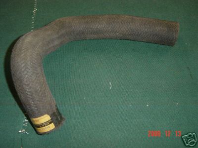

On another note, I know you like the braided hoses and thought you should check this out.
http://cgi.ebay.com/ebaymotors/Datsun-Z-240z-260z-Braided-Lower-Radiator-Hose-NOS-Rare_W0QQcmdZViewItemQQcategoryZ34201QQhashZitem230065736759QQihZ013QQitemZ230065736759QQrdZ1

I think I can get the hose clamps OK - it is the water valve screws that are trouble. I like the slot idea - I'll need to figure out how to get a tool in there...
Thanks Moonpup - I am watching that auction as we speak!
Apologiesin advance. I just read the above posts and found that you were really talking about the small phillips. (Post below is about stubborn hose clamps) Regarding the valve screws... I had to use Vise grips on mine. Parts blaster was sprayed on a few minutes before. They make small vise grips which are ideal for this kind of thing.

Sears makes a handy little tool called a screwout that has a left hand bitting/cutting edge that bites into whats left of the screw head and turns the screw out.
Looks like this is what you are talking about:
http://www.sears.com/sr/javasr/product.do?pid=00952154000
Interesting.......Now if I could just fit my drill up under the dash it might work!

I was able to use the tiny vise grips to get mine out. As someone else said, you can use a dremel tool if that doesn't work with a flex shaft on it to cut a slot, then use a flat bit on a small 1/4" ratchet which will give you enough room to put pressure on the head of the ratchet while turning it.
