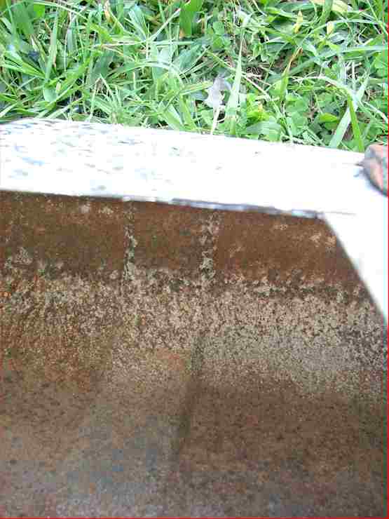

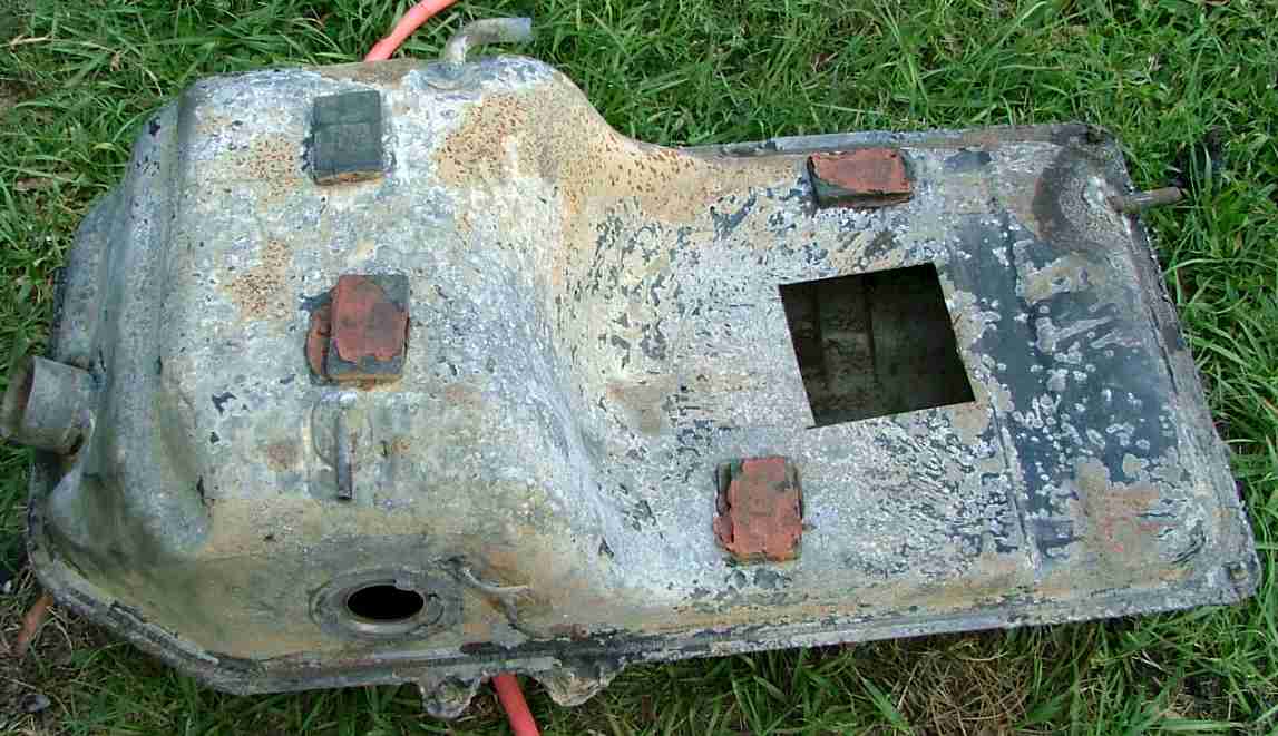

Attachments are post tank cleaning/electrolysis. Single "L" shaped electrode was used inside tank. Tank was completely immersed in water and washing soda (environmentaly friendly). DC welder on 20 Amps was used for two days. Note how more rust was removed in areas closer to the electrode. Hole was cut in tank AFTER electrolysis. Coatings inside and outside of tank were removed by this process. Tank was sandblasted inside and out afterwards.
