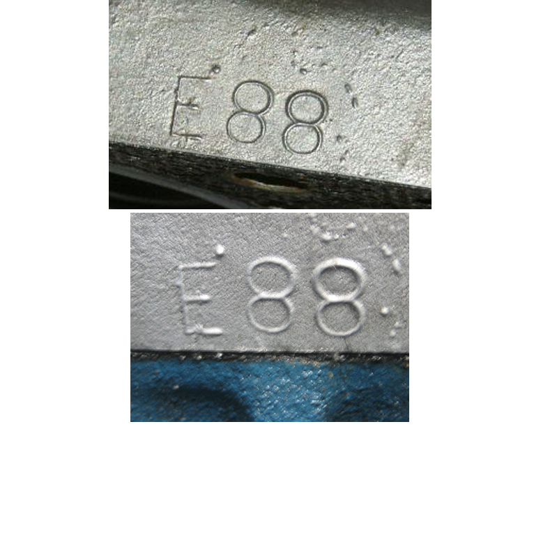

December 20, 200519 yr comment_149579 This is a picture of what I believe is the early casting with the skinny E and the uniform 8's. I have read conflicting information that this represents the later emmision enflicted e88. Link to comment https://www.classiczcars.com/forums/topic/2272-e88-not-the-best-head/?&page=3#findComment-149579 Share on other sites More sharing options...
December 20, 200519 yr comment_149582 I have also seen later E88s with a small E and small 8s. I'll see if I can find one. Link to comment https://www.classiczcars.com/forums/topic/2272-e88-not-the-best-head/?&page=3#findComment-149582 Share on other sites More sharing options...

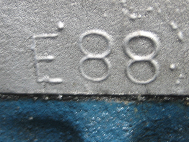

April 14, 200618 yr comment_163426 Just thought I would revive this a little since I found an interesting photo. I don't know how many casts were used in the casting of the heads, but I thought it interesting that the dimples and everything are identicle to my E88 as this pictures I yanked off a recent ebay ad. The guy selling it didn't have a pic of the underneath so I could'nt see if it was notched or not, but he said it was original to the 72' he pulled it off of??? I'm not going to be pulling my head anytime soon, hopefully, and I guess that is the only true way to tell if it's early or late...anyhow, I thought the similarities were neat. Link to comment https://www.classiczcars.com/forums/topic/2272-e88-not-the-best-head/?&page=3#findComment-163426 Share on other sites More sharing options...

April 14, 200618 yr comment_163470 I was referring more to the casting mark similarities of potentially the early or late head. My engine is an ATK rebuild on an L26. I have read that the lettering similiar to my "E88" have been known to be both early and late. If I do have an later head, and the ebay in fact was an early, that means they are around three years difference and used the same cast...right? Link to comment https://www.classiczcars.com/forums/topic/2272-e88-not-the-best-head/?&page=3#findComment-163470 Share on other sites More sharing options...
