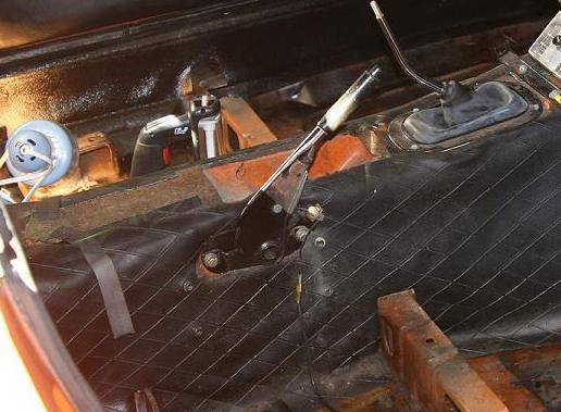

If you want to, you can buy the snaps that use a screw to attach to the trans tunnel around the brake handle. Find a place that does boat/trailer covers, or maybe a place that does pickup tonneau tops. You'll need to remove the passenger seat and slide cover on the handle to see where the snaps will screw in.
My car didn't have one in it when I got it, and I didn't see any holes where screws may have been. Is there a usual reason?
Bart said it, the original transmission tunnel covering was the diamond vinyl. It had the male snaps attached to it.
You can buy snaps at fabric stores as kits. There are the sew in style as well as the hammer-rivet style. It all depends on how you want to attach them.
However, since you don't currently have the snaps in there at all, what's wrong with your Dad's idea? The velcro could be added to the e-boot easily and the other end attached to the carpet you already have on the tunnel.
Just be careful that the "hook" side of the velcro gets attached to the e-boot, and the soft fuzzy side to the tunnel.
Otherwise, if the boot should come off whether partially or completely, the "hooks" will be exposed and any unsuspecting knit type of clothing will be snagged. If your girlfriend's favorite slacks get ruined by that velcro, you'll be repairing more than the car.
